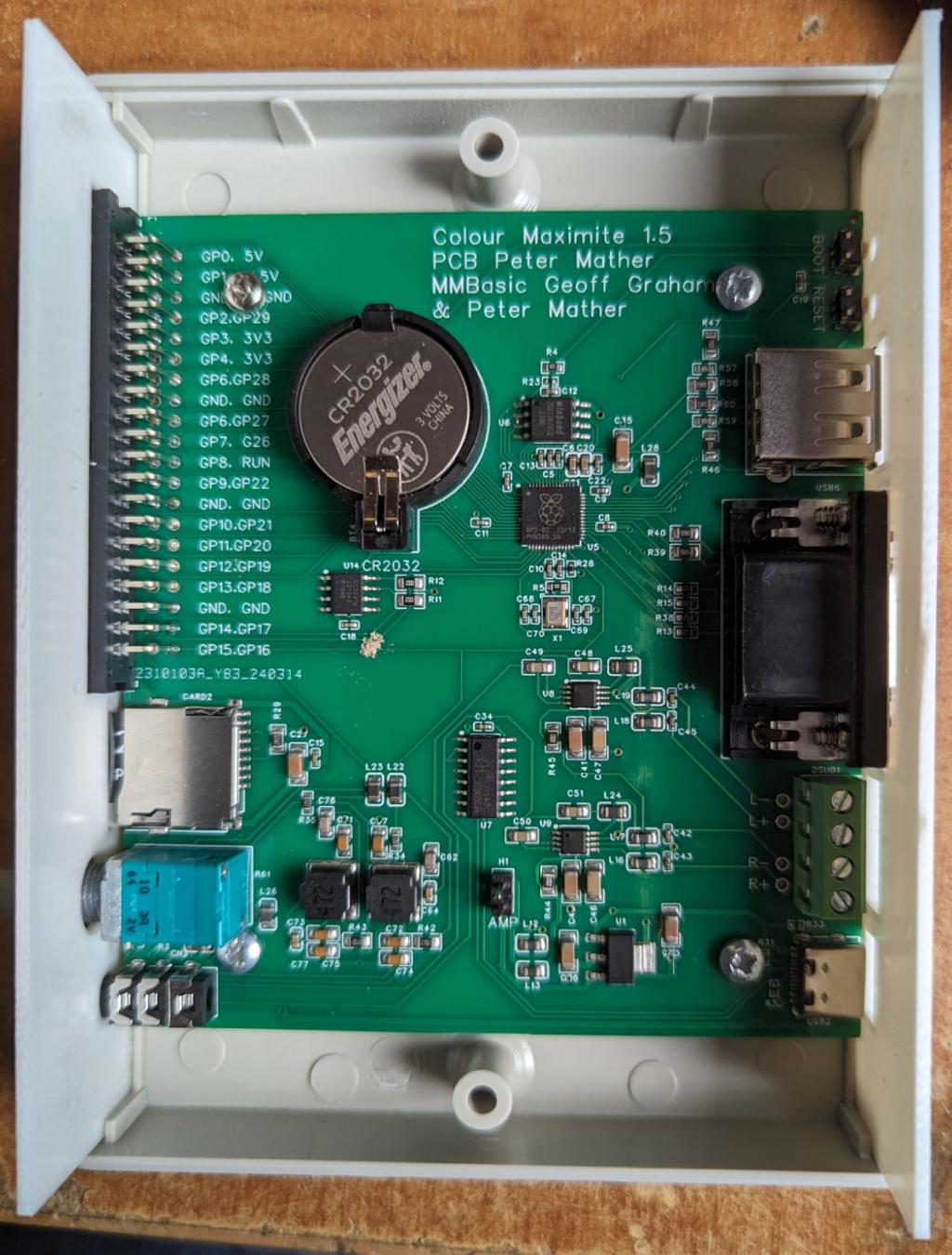

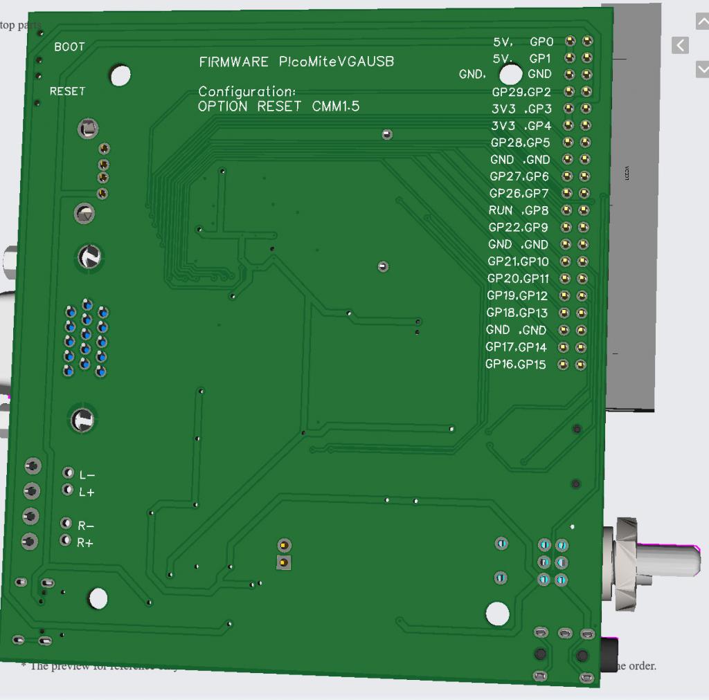

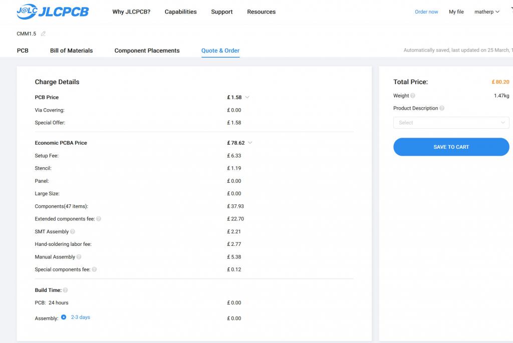

The CMM1.5 is a platform for running the PicoMiteVGAUSB software. Attached are all the design files to allow anyone to build this. The box is the MULTICOMP MCRM2015S. Price for 5 boards fully complete and ready to run from JLC is £80.20 + shipping and any country dependent taxes.
The push button on the volume control is non-latching so it can't be used for an on-off switch. Instead it is connected to GND and GP0 allowing it to be used as a user input for a program.
To install the firmware connect a USB-A to USB-A cable to the USB-A socket while holding down the "BOOT" switch. Copy the PicoMiteVGAUSB V5.09 firmware .uf2 file to the disk drive created by the RP2040. Then remove the USB-A cable and connect a USB-C for a console. Type OPTION RESET CMM1.5 and you are then fully configured

Hi Peter,
JLC has removed the top copper cooling of U1. This may not be a huge issue, but the board is not the same as the 3D simulation files you included in this same post.
P.S. You should not eat cookies while making photographs.......DS3231

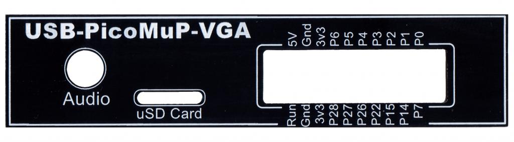

Trying to get JLC to 3D print the end-panels for the box, but no matter WHAT type of 3D printing I select(material or technology), it is rejected as being too small.
Peter?
Posts: 12037
Posted: 06:43am 21 May 2024
No idea. I printed myself. You could convert the DXF files to Gerbers and get them made as pcbs
Posted: 06:51am 21 May 2024
Hi Grogster, All,
It looks like a face plate, I agree with Peter, get them done as PCBs
Here is a scan of one I have just had made in the last month.
Kind regards,
Mick (The Big one)
EDIT***
I got this one made in 0.8mm but of course you can get any size that they do PCBs in.
Mik
Edited 2024-05-21 16:54 by bigmik
Posts: 6187
Posted: 06:56am 21 May 2024
You selected 0.15cm thick, and 0.2cm (2mm) thick is the minimum they offer.
You could redesign the panels to be 0.2cm thick, and have the edges slimmed down to 0.15cm.
Posts: 10071
Posted: 06:57am 21 May 2024
Thanks.
Can anyone recommend a program to convert the DXF's to GERBER's?
I cannot import DXF's to my PCB program.
I'd actually PREFER to do them as black PCB's, but I could not import the DXF files.
Perhaps if I can get a little prod in that direction, I can then take it from there.

Posted: 07:34am 21 May 2024
Grogster,
It wouldn’t be difficult to just redesign them in your PCB program.
A note on cut-outs though.
DEXpcb creates a seperate Gerber file for the cutout areas.
JLC used to be quite happy with this and do the cutouts as designed.
They have changed something now and require that the cutouts be on the border Gerber file.
They will still do them with a seperate cutouts.gbr file but NOT automatically.
You need to request confirmation of the manufacturing and add a comment about the Gerber for cutouts.
Before they start you can see the output and if the cutouts are not White then they will not be cutout of the PCB. If they are white then confirm the manufacture and all ‘should’ be OK.
BTW, JLC are now able to do full colour PCBs and have an introductory offer BUT the design has to be created using their EASY-EDA program and I don’t have a desire to learn a new program.
Besides the cost is quite considerable compared to the peanuts price of the standard process.
This would make for really nice face plates.
Mick.

Posted: 11:00am 21 May 2024
Hi Mick, All,
With Dex, I can’t dictate what gerber layer cutouts are placed in.
I asked the creator of Dex if he could support adding cutouts to the border gerber but he refused stating that it is not standard to do so, so he won’t add that support.
I can get over the problem as I itemised above but it is a PiTa, and as I said JLC used to automatically action the cutouts when they were in their own gerber file.
I tried a program called GerbMerge and it would combine two gerber files into one but it would lose registration to the other files so was of no use.
Does anyone know if there is a method of merging 2 gerbers into one that keeps the registration used in both when the merged one is exported?

Posted: 12:41am 22 May 2024
Yes, when I did the panels for the CMM2 and G2, they were done as blank black PCB's with silkscreen only.  They look great, and are easy etc.
I suppose I can just draw up my own ones.  I figured the DXF file would speed that along, but perhaps not!
I have to do the new CMM2 panels too, so I suppose I could just settle into doing them both at the same time, while I am thinking about it.
Yes, I put all the cutouts on the "Outline Layer" in Sprint Layout, and they always came back fine from JLC.  I did have to put a note in the order(translated to Chinese) saying these were just panels, not-solderable, no copper, just black ink and silkscreen, otherwise they did tend to question why there was no copper etc.
