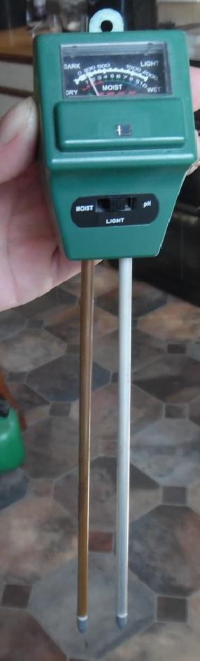

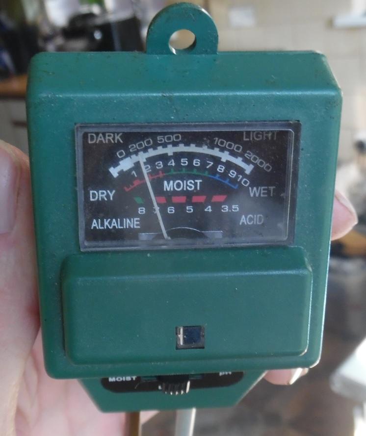

I bought this ph tester and it works but don't know how?? no batteries.
Posts: 6187
Posted: 05:29pm 31 Mar 2024
Chemistry. 2 different metal electrodes, acid, creates a voltage. That is how lead acid batteries work.

  Volhout said  Chemistry. 2 different metal electrodes, acid, creates a voltage. That is how lead acid batteries work.
lead acid is one metal.
search 2 dissimilar metals

The electrodes look like copper and another metal. It might be a so-called "Clarke cell", using an antimony/oxide electrode. It was cheap and used for measuring oxygen levels, but depended strongly on pH, temperature, etc and had poor results.
