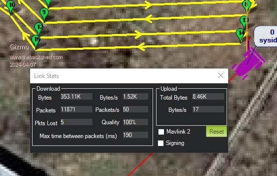

Posted: 04:12am 07 Apr 2024
OK, now its working.
Added some buffering on incoming serial data. I also set the wifi to 802.11 LR (Long Range) mode.
The only time I lost a few packets was when I uploaded a new set of waypoints. The two ESP's are about 30 meters apart, one in the yard and the other in the house. Both have external aerials fitted, good supply power and a 100uF cap fitted across the supply at the module.
The updated code for the access point ( on the rover )...
