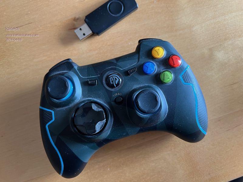

I wanted to remote-control my robot with a gamepad controller, but not with a wired one. I got a Sony PS4 controller but this uses Bluetooth, unfortunately. With the cable, it works - that is, it is recognized by PicoMiteUSB - but walking a robot on a leash is besides the point ...
I thought just adding vendor and device ID of my trusted wireless gamepad to the PicoMiteUSB firmware might do the trick. Well, my controller can produce at least 4 vendor/device ID combinations and almost as many data formats. In PS3 mode, it is not recognized by the firmware, probably because the connection between dongle and controller takes too long to negotiate; MMBasic "looses interest" and disconnects the controller.
Therefore, I decided to see if I can add a controller type (here, XBox/Android) to the firmware ...

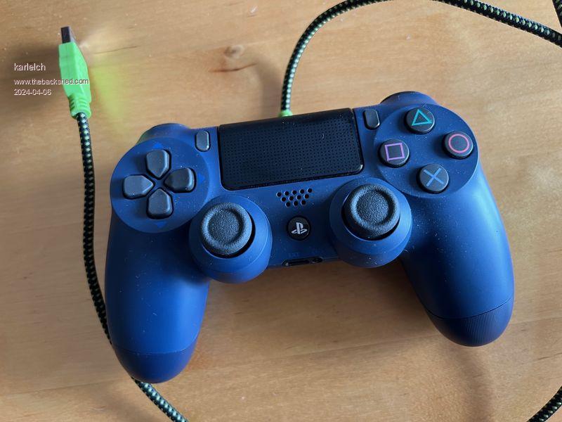

A small Basic program to test gamepads (I tested it with the PS4 controller as well) you can find here: gamepad_test.bas

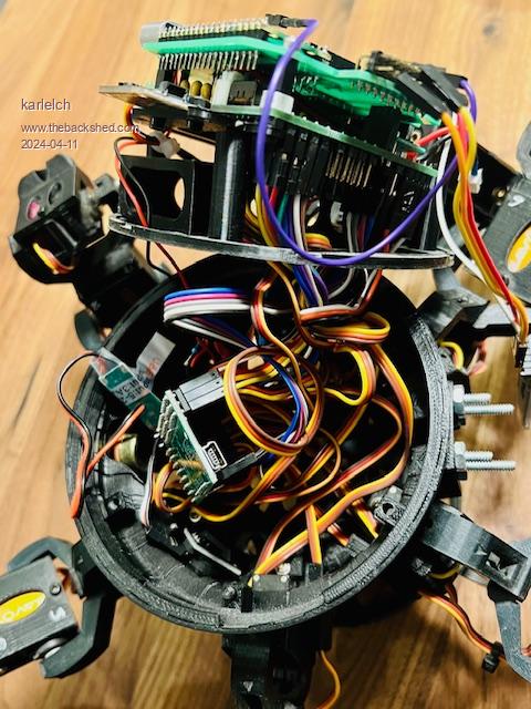

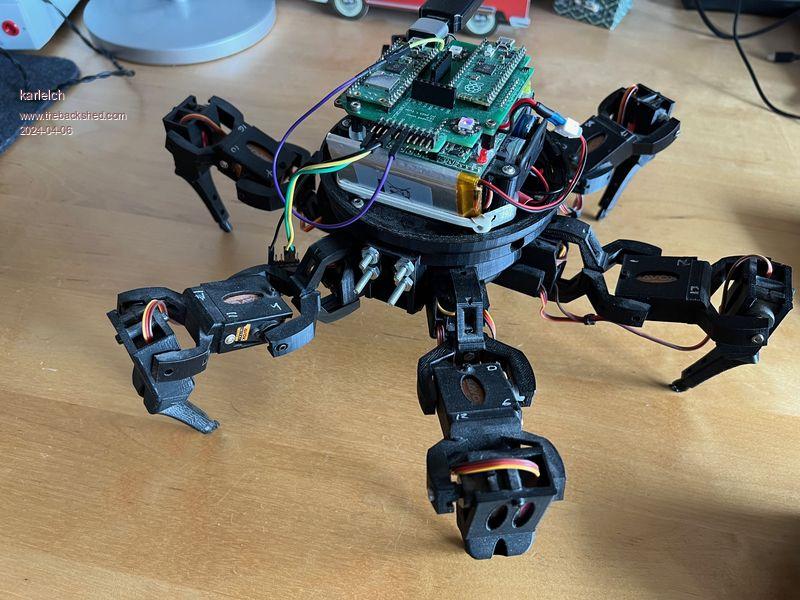

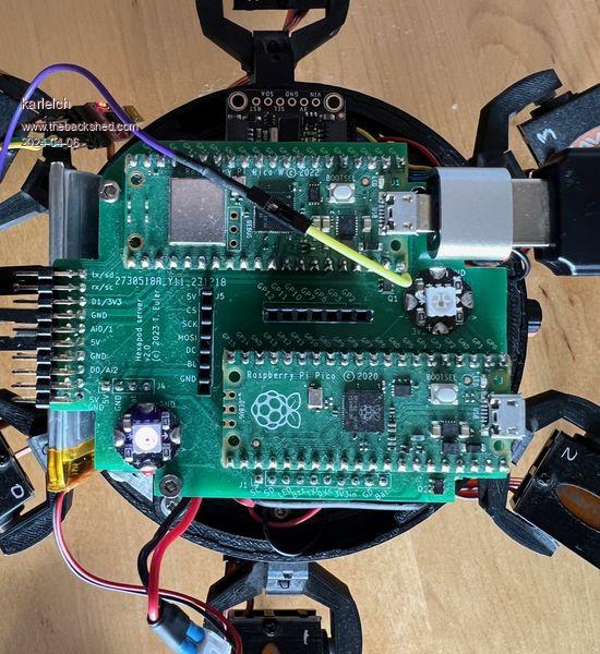

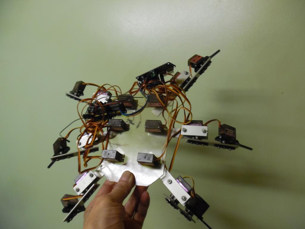

The robot is one of my long-long-term projects (one can see that from the dust on some parts ...   ).
The mechanical setup was inspired by the remote-controlled Arduino-based vorpal robot, but with one more joint per leg added.
Its 18 servo motors are controlled by a Maestro 18, which receives commands from one of two Pico (W) microcontrollers. They both run MMBasic, one -- the server -- controls the gait and generates the leg movements, the second one -- the client -- currently receives the gamepad input and talks to the server via a serial connection. Eventually, the client will control the robot autonomously.
Other features are:
- 8-channel servo-load sensing
- BNO055-based 9-DOF IMU
- two WS2812 LEDs for signalling the robot's state
- a TFT display (not mounted here)
- a buzzer
- separate logic and servo batteries with voltage monitoring
- hardware handshaking between the Picos
- a potentiometer for mode selection (not yet used)
Originally, I developed MicroPython code for it but gave up at some point, because it did too much in the background (e.g., garbage collection) and that kept messing up the servo update timing as well as the communication between the two "brains" ... Newer MicroPython releases may be better with that now, but I was wondering if a solution with MMBasic running on "bare metal" on a Pico would be better. And indeed, it runs very well and reliable, the communication between the Picos is a dream.
And if the timing is too slow, I just overclock it more
Finally, here's a video,
I'll document the hardware and the MMBasic code soon in the repository - in case someone is interested.

Of course, you can add it, however, I am not sure how useful that is for others. I bought it 4 years ago to work with my Windows PC, which is does well. It is from a company called EasySMX (PS3 Controller, EasySMX 2,4G Wireless Gamepad, Joysticks Dual Vibration TURBO) and it can work in different modes:
Note that it is not really "XBox" - I gave it that name in the code before I figured out  what it really is. Depending on the mode, it returns different vendor/device ID combinations and data packages:
"Android", vendor ID: 0x11c0, product ID: 0x5500
"X-input", vendor ID: 0x045e, product ID: 0x028e
"D-input, emulation", vendor ID: 0x11c1, product ID: 0x9101
"PS3", vendor ID: 0x054c, product ID: 0x09cc
When connected to a Windows 11 PC, all modes are recognized.
For the PicoMiteUSB, "PS3" would have been the obvious choice, by just adding another device ID to your `is_sony_ds3()` function, but for some reason that did now work. This is the controllers default mode. When it is started, it behaves like a PS3 controller. But then changes mode, if no PlayStation responds (I guess). This is probably why the PicoMiteUSB firmware was not able to stay connected.
"D-input, emulation" works but generates very long (27 byte) data packages that contain all relevant data (some redundantly).
"Android" generates nicely compact 9-byte data packages, providing data about almost all buttons and joy sticks that your firmware supports, therefore I opted for this format.
To cut a long story short, I think it would be great to add another type of controller/gamepad, but I am not sure which format. Maybe that "Android" format, that I mislabelled in my code as XBOX. However, I don't know how common that is.
As to the wireless: I expect that Gamepads that use a special dongle (like the one here) should generally work - if their IDs/data format are known and they make it through the "negotiation phase". All newer wireless gamepads seem to rely on Bluetooth and are therefore out of the question.

Posted: 08:35pm 06 Apr 2024
impressive! I never finished mine, it's not easy

#define TE_TEST 0
#if(TE_TEST)
// Add your IDs here for testing
#define ANDROID 131
#define TE_V_ID 0x11c0
#define TE_P_ID 0x5500
#else
// EasySMX Wireless, u, Android mode (u)
#define ANDROID 131
#endif
If `TE_TEST` is set to 1, then the code uses the IDs given in the first branch of the `#if()` directive and prints out the data from the gamepad as soon as it is connected to the Pico. (Of course, this requires re-building the firmware). The result in Tera Term looks something like this:
9 0_0 1_0 2_F 3_80 4_80 5_80 6_80 7_0 8_0
With the first number being the number of data bytes to follow (here 9), and the following `x_y` pairs the byte index (`x`) and the value (`y`). When you then move the joystick of your gamepad or press a key, you should see how the values are changing. This way you find out, which control is reflected in which data byte and how the message is to be decoded.
Note that the Pico is only printing the data, it does not populate the MMBasic-specific gamepad variables in this test mode.
3) Based on that, one can then add decoding code to `USBKeyboard.c`.
Of course, this cannot be a general solution - everyone adding their favorite gamepad. But maybe having one commonly used class of gamepads (e.g. XBox) in addition to PS3/PS4 would be useful for many.
Best

Posted: 08:28am 11 Apr 2024
Burned out servo   ... surgery required ...
