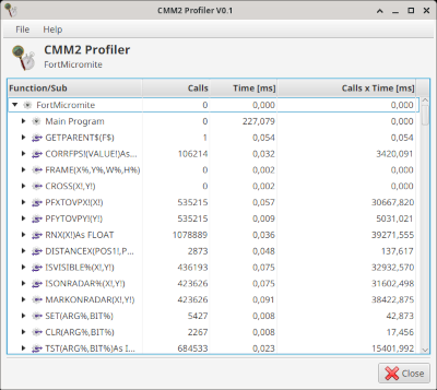

Therefore I wrote a small tool in Java (running on Windows and Linux) called CMM2Profiler, that makes life a bit easier here.
You can load a profiler log and do some basic analaysis. Screenshot below.
The source code is on GitHub but for all who don't want to compile the java code, I put a precompiled version in the GitHub Wiki:
  https://github.com/grimm-git/CMM2Profiler/wiki.

Might I suggest giving the user the ability to sort on the different columns? I know I'd like to see the last column (Calls x Time) in decreasing order so I could determine the biggest "offenders" at a glance.
joker
Joined: 06/02/2024
Posts: 54
Posted: 07:33pm 11 Apr 2024
Yes, you might
But it is already built in.
Just click on the column headers until you get the sort order you prefer.
