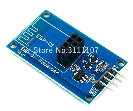

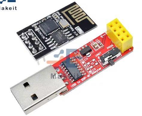

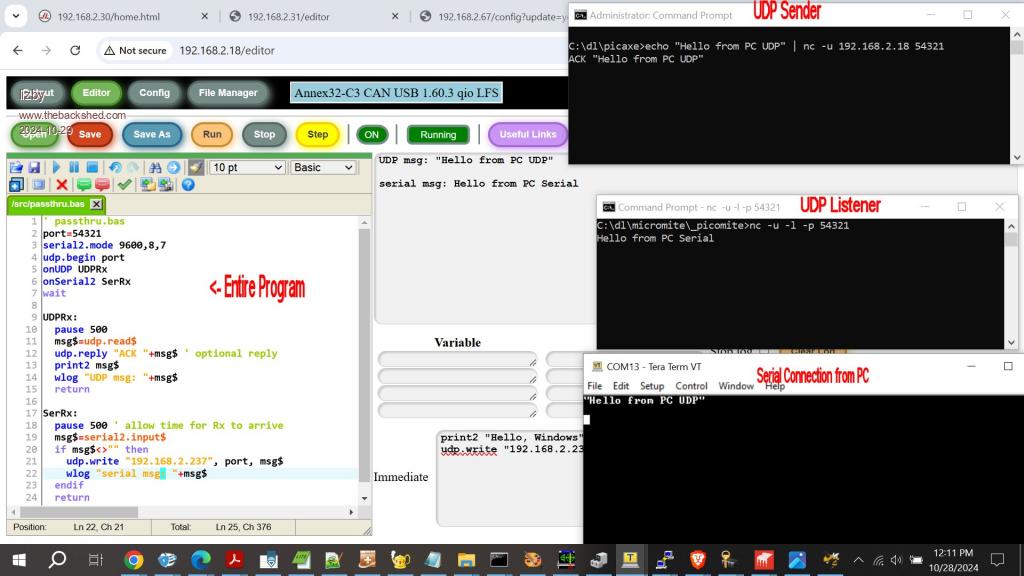

Easy to flash any variety of ESP from your browser. Then when connected, you have a browser-based editor and run/debug environment with a programming language which will be familiar. If all you want to do is send and receive messages, this is easily done with not very many lines of code, and you have the choice of UDP, ESP-Now, MQTT, serial, and email.
For the ESP-01S (which has no USB), I flash with this adaptor:
For Firmware Flashing
Easy to connect via serial with this adaptor:
