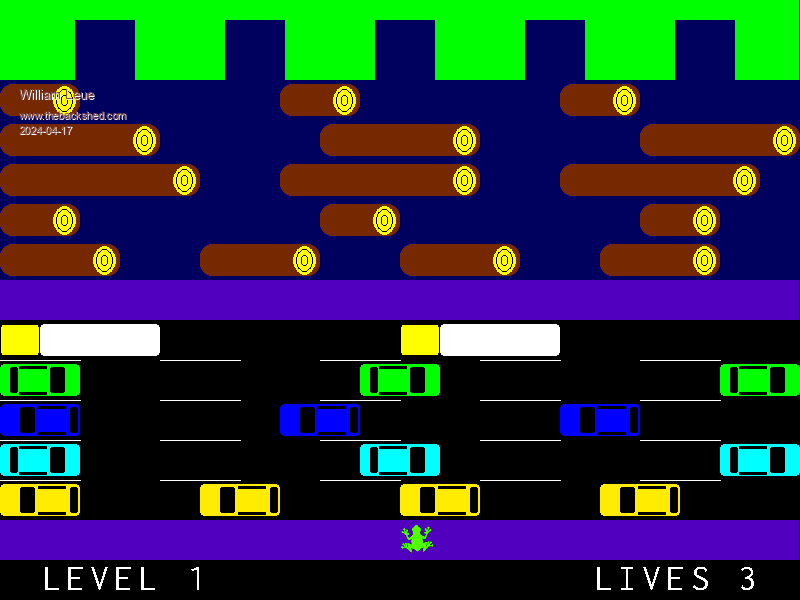

I know there is at least one other Frogger-type game (for Picomite?) but this is mine for the CMM2.
Frogger.zip
Enjoy!
-Bill
