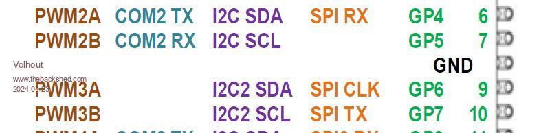

All PicoMites (also the webmite) have 2 hardware I2C blocks inside.
These are called I2C and I2C2.
In the pin diagram in the user manual (page 9 for webmite) you can see which hardware block can be assigned the which pins.
But you can write software for 2 independent I2C busses.
Your problem os that GP5 and GP6 belong to different hardware blocks. I suggest you connect the GP5 wire to GP7, change the SETPIN to include GP7 is stead of GP5, then all will be fine.
