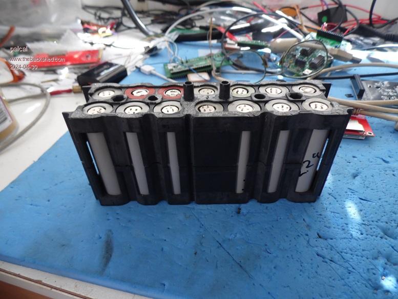

For those in Oz, I found this site Lithium Cells
I bought 10 to see what I get. I'm a bit wary of Lithium-Ion cells, They are good in one way but I never leave them unattended when charging and use all the protection possible.

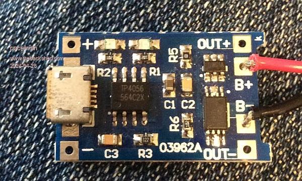

I bought a couple of these modules
three years ago, then got worried about the cut-off voltage of 2.4v which seemed a bit low for longevity of LiPo cells.
They have just three active chips:
TP4056 - Charger IC for Li ion.
ML8205A - Dual mosfet, switches low side.
DW01A - Battery protection IC, cuts load at 2.4v.
Somewhere I read that the DW01A cutoff was a bit low for battery (18650) longevity and a better chip might be the FS312F which cuts load at 2.9v. I bought some of them then tried to change one. That wasn't a goer unfortunately (ham fingers) but the original module seems to work OK for one battery so I gave up.
Any comments about the usefulness of changing these, or should I just bin them.

Posts: 9224
Posted: 06:48am 28 Apr 2024
Bear in mind that the DW01A disconnects the battery at 2V4 - but that is an on-load voltage. At that point the battery is unable to supply significant current as its internal resistance has increased. Once the load has been disconnected the terminal voltage of the battery actually increases to about 3V, but there is no current drawn as it's been disconnected. The load will remain disconnected until the voltage will reliably remain above 3V.
paceman
Joined: 07/10/2011
Posted: 02:38am 29 Apr 2024
Ah ha, thanks Mick - that's something that didn't occur to me.
It's a bit surprising that that point is not highlighted more in discussions about cutoff but then maybe I've just half ignored any 'under load' qualification. I won't in future!
Posts: 9224
Posted: 07:42am 29 Apr 2024
It's not very obvious, maybe that's why. When you think about it it makes sense though - the terminal voltage can only ever be read under some sort of load, even if it's only that of the measuring device! The *true* terminal voltage can never be read, only approximated by using a very high resistance device. The DW01A alone could be drawing as much as 6uA.
