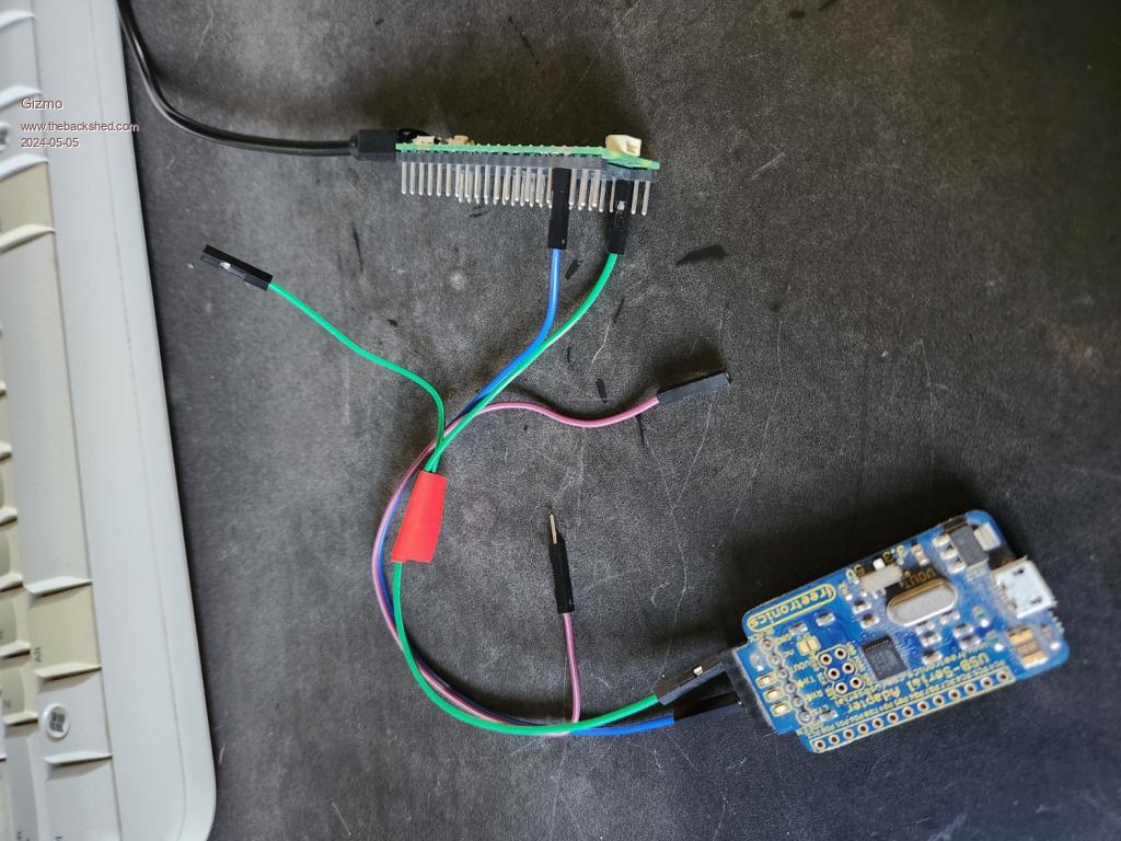

Another weird thing I discovered, this configuration below causes the Pi Pico to drop the USB ( maybe lock up or reboot )....
Now thats a serial to USB adapter, not plugged into anything. It's Tx line was connected to pin 17 of the Pi Pico, and the earths connected. Thats it, no other wires. After I did the "option system I2C disable", it's fine
