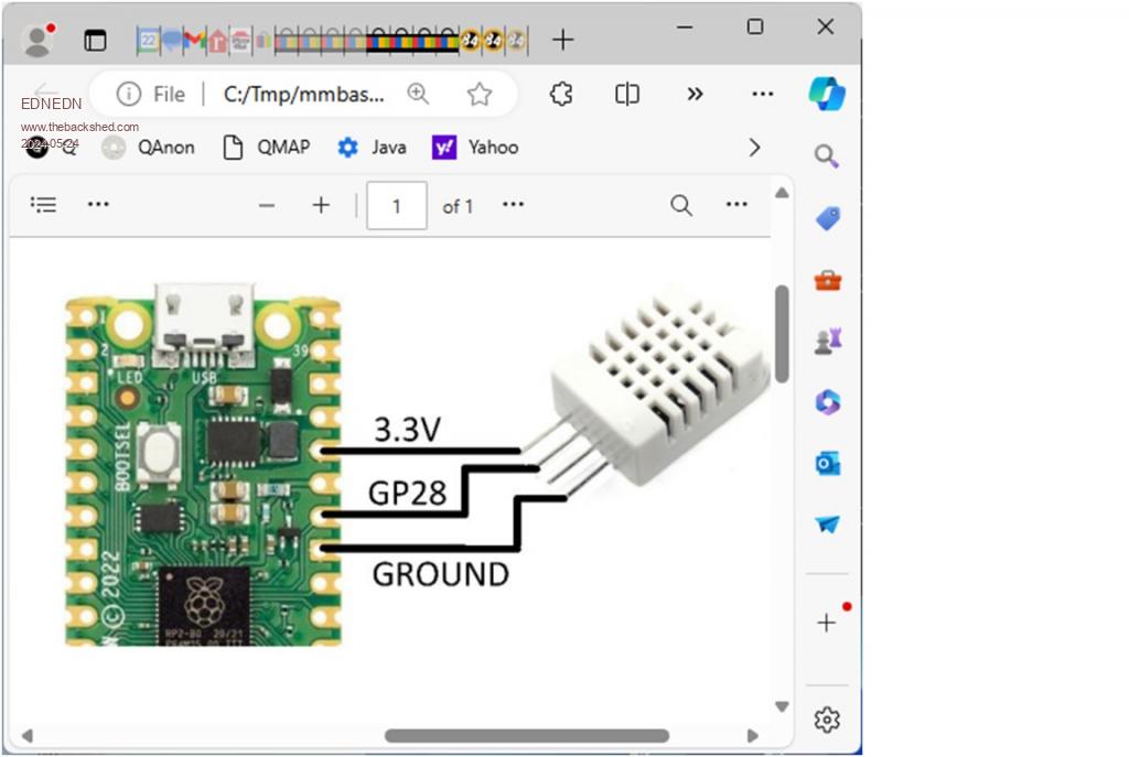

I just got a Pico-W in the mail and I figured I would load up the WebMite firmware and put the Humidity and Temperature web page code on it.   I got the web page to show on my browser but I'm getting 1000 for both Humidity and the Temperature.   And the documentation says that is what I will get if I don't have a DHT22 sensor connected.
I'm just curious.   Looking at the demo code it seems like the bit banging should be down on GP28 to match the circuit shown on the demo page.   Of course I tried that, but I'm still getting a temperature of 1000.
Does anybody have any ideas what I should check?    I'm wondering if I got sent a DHT-11 by accident?   Does anybody know if the initialization and command set are the same for the two parts?

Try increasing the pause to 2000. DHT sensors won't wake up if the pause is too short.
If this is on a breadboard check continuity from the Pico pins to all the DHT pins. Verify that you have 3.3V at the DHT pins. You may also need a pullup resistor, 3.3kΩ to 10kΩ.
See "Measuring Humidity and Temperature" in the manual.

Increasing the Pause to 2000 or 2500 doesn't help.   The connections have the pins of the Dupont wire soldered into the Pico-W.  The other side of the Dupont wires are female and go to the circuit board the Alleged DHT-22 is on.
I'll do the pull up next and see if that helps...

Score!   Changing the GP15 to GP28 and adding the  ",1" to the end of the line made it work.   Even though I specifically ordered a DHT-22 they decided to send me a DHT-11.   Oh Well...   I got the demo working!!!!
