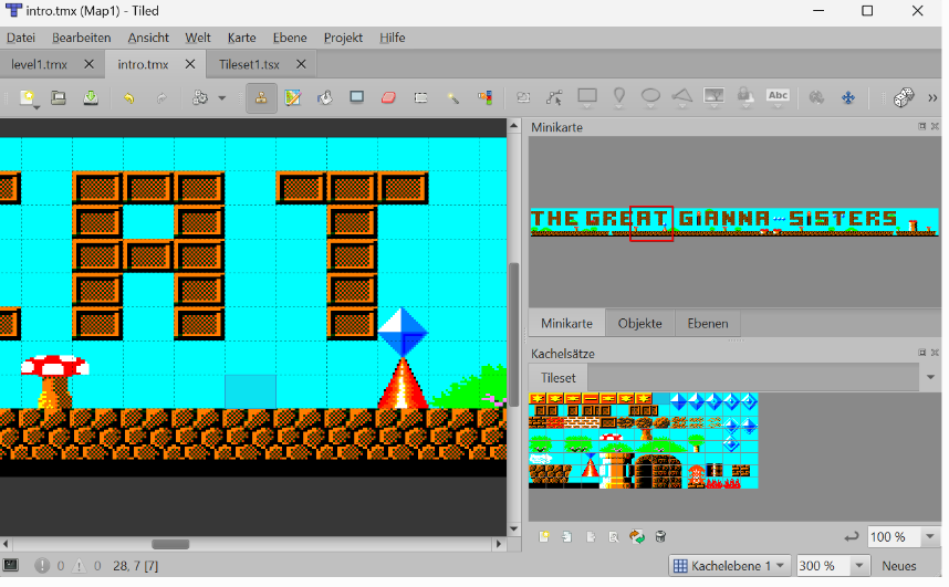

   Description: After you have your tile image in the correct color format, you need to assemble these tiles into level maps.
   Tools Needed: TileEd (a tile map editor).
   Steps:
       Open TileEd and load your tile image.
       Use TileEd to arrange your tiles into the desired level maps. This involves placing tiles in the correct positions to create the layout of each level.
       Once you are satisfied with your level maps, export them as CSV files. TileEd will generate a CSV file that lists the tile numbers in the order they appear in your map.
