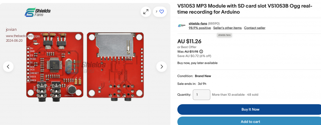

Do you know off hand if this board will work too? I would like to use the VS1053 SD card to save a bunch of internal tones, and have the SD card on the PICO res touch available to the user...

If the two SD sockets are on the same SPI bus use a DOUT pin and some logic to switch the CS line from one to the other.

That VS1053 is supported for audio output by MMBasic but it requires a SPI of its own. I'm pretty sure that you can't enable both the uSD card and the VS1053 on the same SPI channel. The audio inputs are not supported.
It sounds rather nice to my ancient and non-hifi calibrated ears. :)

  Mixtel90 said  That VS1053 is supported for audio output by MMBasic but it requires a SPI of its own. I'm pretty sure that you can't enable both the uSD card and the VS1053 on the same SPI channel. The audio inputs are not supported.
Yes I'm happy if the inbuilt SD card is not accessible as it will contain ROM sounds. I'll buy a couple and try them out. Thanks for the help.

I am not sure the module gives access to the module's SDcard lines. The chip may have full control over these lines. Especially when you can also use it to "record" audio.
Also, I am not sure if the picomite can handle "user switched" control of 2 SD cards on the same SPI bus (or different SPI busses).

Both sockets will appear as Drive B: so it is up to the user to know which is which and not to switch while the bus is active.
Selecting Drive A: before switching B: sockets should prevent MMBasic getting confused.
A dummy file on each card with a file name that identifies it would help.
Eg:-
AA_SDcard_01.txt
AA_SDcard_02.txt
AA_SDcard_03.txt
Starting with AA puts it at the top of "files".
It could even be a toggle switch instead of logic.

SDcards have to be initialised to put them into SPI mode. This happens once each time after a card is inserted when it is first used. A heartbeat then checks the card is still functioning every second or so. This allows insertion and removal without a CD pin.
The initialisation uses a particular sequence where the SPI clock is pulsed WITHOUT CS selected. It is very unlikely that two SD cards on the same SPI channel can be made to work with the MMbasic firmware as written.
As Mixtel90 notes, the VS1053 uses a dedicated SPI bus and MMBasic CANNOT use an SDcard that shares that bus
