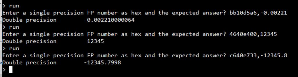

In another thread a reading from a sensor was returning a single precision floating point number.
This post shows how to convert this to a standard MMBasic double with a bit of of simple bit-twiddling.
Option explicit
Option default none
Dim w%,s$,c%,d%,e%,o%,a!,i!
Input "Enter a single precision FP number as hex and the expected answer";s$,i!
If Left$(s$,2)<>"&H" Then s$="&H"+s$
Poke word Peek(varaddr w%),Val(s$) 'store the single precision floating point
c%=(w% And &H80000000)<<32 'get the sign bit
d%=(w% And &h7FFFFF)<<29 'get the mantissa
e%=(((w% And &H7f800000)>>23)-127+1023)<<52 'get the exponent and convert
o%=(c% Or d% Or e%)
Poke integer Peek(varaddr a!),o% 'put the answer into a double
Print "Double precision", a!

function CDBL(s$) tested and gives same results as Peter's original post.
