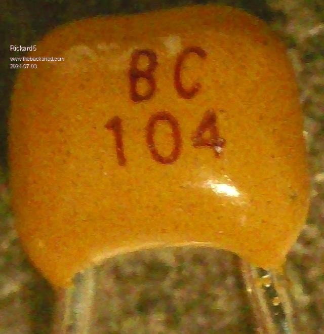

I have been having a problem with all 3 Picomite VGA design #1 SD Cards, and tried changing the SD card socket 2 times and I'm out of Sockets , I've even tried A bunch of SD Card and Micro SD cards, and swapping picos. so the last link in the chain is the 100nF Ceramic or MKT Capacitor. I'm trying to order the 100nf cap but I can Find them on Mouser, Digi-Key or Newark, My such Fu is Week could anyone help me find it on one of those sites
here is the Caps I used,  I might have mis-labeled the bag they were in, I can't read these

  Quote  here is the Caps I used,  ... I can't read these
104 = 10 x 10^4 pF = 100nF.
Same system as resistor colour codes without the colours.

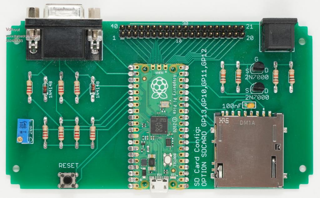

Posted: 09:12am 03 Jul 2024
The design 1 board does not have a 2R2 resistor and my one works fine with just the 104 capacitor

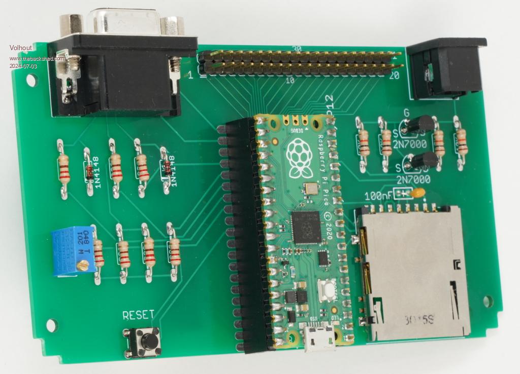

Rickard,
Then you can only suspect the soldering of the Pico itself.
Did you surface mount the pico as below
Or did you use a header and pins (as below)
