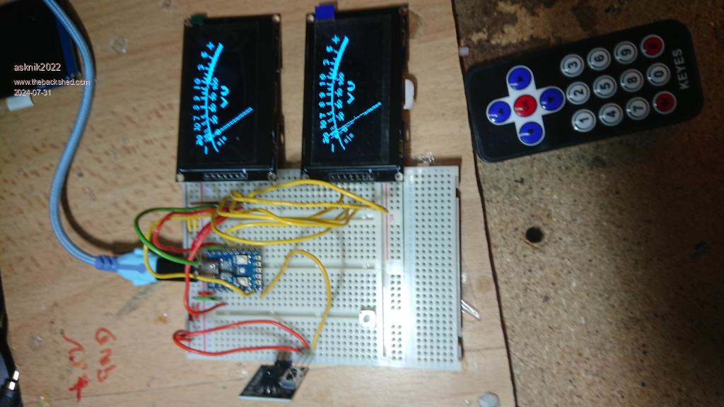

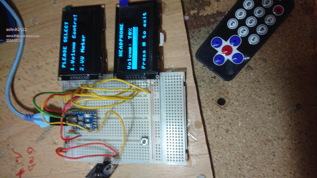

Volume + Vu Meter control in Micropython via IR
IR button 1 for volume control
IR button 2 for Vu Meter showing both Channels
IR button # to return to select screen.

Like the project ! Low wire-count for what it does.
I have forgotten how convenient the IR remote controller is,
I remember, years ago, how pleased I was to find it built into MMBasic
could I ask where you got that type with UDLR buttons ?
also, anyone, I don't think MMBasic drives SSD1309 natively ?

I had to write this in Micropython because MMBasic doesn't suppport the SSD1309
Is anyone wants the code then let me know.

The displays can be configured for both but to save pins I converted them to I2C

Looking at the code, I realize you are using the SSD1306 driver in 128x64 size.
I am using SSD1306 in 128x64 size using I2C also for my projects using PicoMite. But this is not a SSD1309, but a SSD1306. Or are both compatible  and use same screen size.
Fact remains that PicoMite defaults to 1 display, and will require all kind of tricks to control 2 displays.
