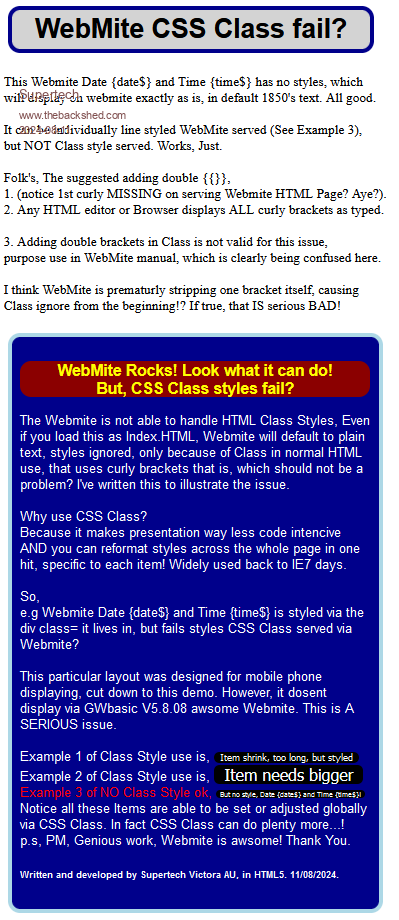

1. I decided to write a demo HTML which shows for itself what is going on. Self explanatory. Just write in the code!
2. PM, use this demo to fix issue please as it is seemingly 'a translation issue' only you can understand at hardware firmware level. Also this problem will affect ALL WebMite uses, even Geoff demos and manual, specifically HTML compatibility going forward. I'm an ex programmer of many years, so I know, but not as Genius as what you've pulled off here.  Quote of David Letterman, "There is no 'Off' position on the Genius switch." Absolutely!
3. I put considerable time to write it for me to help you sort it and teach other members semi Proper HTML5 as I see a lot of horrendous HTML in this forum, no offense meant dear member's!
For those who are proper HTML proficient, It speaks for itself, please load and read notes embedded in it.
Anyone can  and try the demo here index DBA 110824 for Webmite TBS.zip by
A. Loading into any Browser as is,
and comparing it with,
first, rename this HTML to default index.HTML, then
B. Loading into WebMite itself and browsing its served page, even via a mobile phone it is designed to display on, comparing results. For those that do this, you'll see my shock...
I put an exact snapshot, to show how it 'should look' on any proper browser, and have written it in latest HTML5.
Note to those who say "WebMite is not capable of this very code display layout". Very wrong. In fact it is actually running on my project now, and at warp speed exactly same code layout, with lot more detail, but I had to strip all Class data out! Kind of defeats purpose sadly. Look forward to it being fixed.

Webmite uses  curly brackets as the syntax element to specify value substitution. If you want a { to be transmitted to the browser you must replace duplicate the {
So in the in the example above
     <style>
  .myhitxt {
  font-family: Tahoma;
  text-align: center;
  color: darkgrey;
  background-color: black;
  border-radius: 10pt;
</style>
the line should be
  .myhitxt {{
Note also CSS files etc. do not need to be embedded. Just make sure the basic program has code to respond to the browsers request for the css file

One possible problem I see in your HTML is it is not ASCII. I haven't tried your code yet but I worry about characters greater than chr$(127).
The other problem is with the {. MMBasic will scan the file before sending it to substitute variables contained within {}
If you add a second { to your styles MMBasic will change it to a single { and leave the closing } as is. There is no need to double up on the closing }

As PM states, two {{ and } using CSS in HTML DOES work. Not tried on external file CSS yet.
However, kind of defeats purpose of using the HTML { and }. Why?
1. Any HTML editor that can show the live HTML page, dpes this,
A. Cannot show CSS class styles etc as it cannot be displayed, resorting to what Webmite shows as raw text. The very opposite of why Webmite requires {{, thus is NOT HTML CSS compatible ,
B. To then add/remove e.g {{ to { is a massive task, while C. Editor throws at you making mistakes if adding {{ not { it expects, and finally D. Even IF you try to add another { to single; HTML editor rightfully puts it as {{} not the extra {, thus you have to delete editor added } for EVERY CSS COMMAND YOU MAY HAPPEN TO BE USING! Sorry, NOT HTML CSS compatible. Total disaster.
So unfortunately the {{ instead of { is,
For above reasons highly impractical & Impossible to implement.
Can another character be used instead?
Say {. ?
PM your thoughts please...
Posts: 6625
Posted: 02:23am 21 Aug 2024
Most of your perceived problems can be addressed by using a separate style sheet.
MMBasic will not alter a page with a .CSS extension so your {} are safe.
.html files which are scanned and altered will be HTML CSS compatible after scanning if you follow the MMBasic rules.
