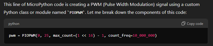

Found some µpython code that wasn't commented and so I handed the line over to ChatGPT:
Components:
pwm:
This is the variable that will hold the PWM object created by the PIOPWM class.
PIOPWM(0, 25, max_count=(1 << 16) - 1, count_freq=10_000_000):
This is the instantiation of the PIOPWM class. It creates a new PWM object with the specified parameters.
0 (First Argument):
This is likely the index or ID of the PIO (Programmable Input/Output) state machine being used. PIO is a feature in some microcontrollers like the RP2040 that allows for highly flexible control over GPIO pins.
25 (Second Argument):
This is the GPIO pin number to which the PWM signal will be output.
max_count=(1 << 16) - 1:
This sets the maximum count value for the PWM. The expression (1 << 16) - 1 is a bitwise operation that shifts 1 left by 16 bits, resulting in 65536, and then subtracts 1, resulting in 65535. This means the PWM counter will count from 0 to 65535 (a 16-bit counter).
count_freq=10_000_000:
This sets the frequency of the counter to 10 MHz (10 million counts per second). The frequency at which the PWM signal is generated is determined by this count frequency in combination with the max_count value.
Summary:
This code creates a PWM signal on GPIO pin 25 using the PIO (Programmable Input/Output) feature. The signal is generated by a 16-bit counter that counts up to 65535, and the counting is done at a frequency of 10 MHz. The PIOPWM class likely abstracts the low-level details of generating PWM signals using the PIO state machines available in some microcontrollers like the RP2040 (found in the Raspberry Pi Pico).

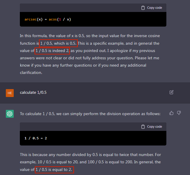

do remember, also, that it makes stuff up (It gave me a mnemonic of CP B,76 in some Z80 code once   )
and check out this straight contradiction trying to back up a miscalculation
have to say I don't use it much because unless you are already frequented well with a subject, you can't trust it to give good info.
