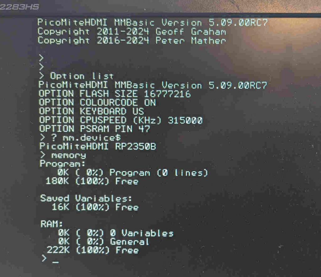

This should behave pretty much like the VGA firmware. CPU speed is fixed at 315MHz and your screen will see 640x480@75Hz
The maximum number of variables is increased to 768 and the maximum number of function/subroutines/labels to 512.
Maximum program size is now 180Kbytes and there is 42Kbytes used for simple variables and variable headers and another 180Kbytes for arrays and strings.

PSRAM can be enabled with
OPTION PSRAM PIN n ' n=0, 8, 19, or 47. If this is done on a RP2350 without PSRAM then the option will be automatically disabled.
To access PSRAM use the address &H11000000
e.g.
poke word &H11000000,&H12345678
? peek(word &H11000000)

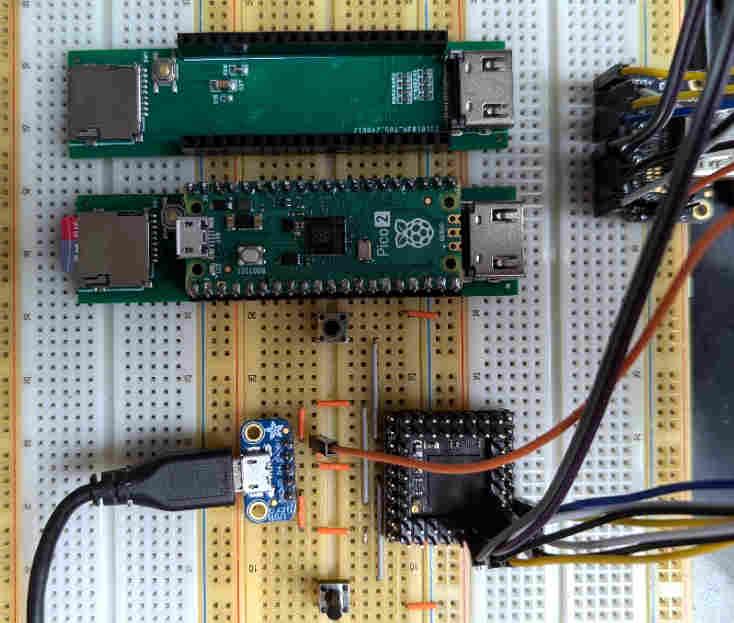

Peter,
What Pico2 hardware are you using?
Based on the info you’ve mentioned, I’ll guess Pimoroni Pico Plus 2 with the Adafruit DVI breakout board 4984
Posts: 11663
Posted: 08:43am 22 Aug 2024
  Quote  What Pico2 hardware are you using?
My own little adapter board (gerbers on the other thread ) and a breadboarded Pimoroni PGA2350
