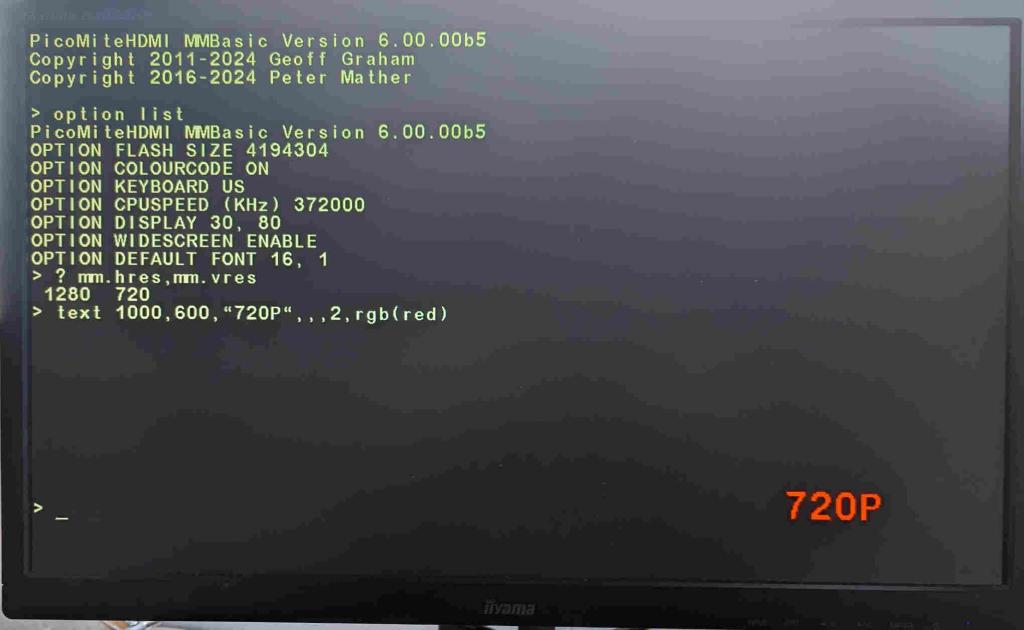

OPTION WIDESCREEN ON/OFF or ENABLE/DISABLE to switch to 1280x720 720P mode
MODE 1 ' 1280x720x2-colours with RGB332 tiles (use the TILE command as normal)
MODE 2 ' 320x180x16colours with optional layer (no memory usage) and colour mapping to RGB332 palette
MODE 3:' 640x360x16 colours with optional layer (significant memory usage) and colour mapping to RGB332 palette
Default font for mode 1 is 3 which is now 16x24

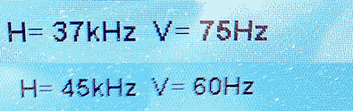

As feared, no improvement at the other entrance. This shows the OSD info normal 4:3 vs 720p:
Edited 2024-09-07 03:01 by homa

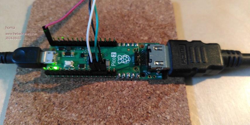

No breadboard
I'm using that at the moment:
I took part in the Plasmamac collective order and an Olimex board has also been ordered.

  Quote  This shows the OSD info normal 4:3 vs 720p:
The 720P timings are exactly correct see here
