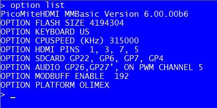

Currently I am trying to configure a standard RPi Pico 2 which has the HDMI b6 firmware installed (non USB). I used OPTION RESET OLIMEX and the following options have been automatically set:
At this point, things appear to be as expected; and indeed I am able to read a uSD card inserted into the Olimex SD socket.

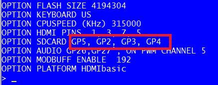

Note the 372000 value in the above error message which I had just previously tried. So, now I'm thinking it is because PLATFORM is set to OLIMEX and perhaps it should be set to HDMIBasic instead. I typed OPTION RESET HDMIBASIC holding out hope it would let me set the cpuspeed value needed for 720P but I noticed the SD pins changed (shown in next image below) so decided to go back to OPTION RESET OLIMEX (hence SD pins now correct once again). [Peter: Note Platform shows 'HDMIbasic' with a lowercase 'b' - trivial, just letting you know]

PicoMiteHDMI MMBasic Version 6.00.00b6
OPTION FLASH SIZE 4194304
OPTION KEYBOARD US
OPTION CPUSPEED (KHz) 372000
OPTION DISPLAY 22, 40
OPTION HDMI PINS  1, 3, 7, 5
OPTION WIDESCREEN ENABLE
OPTION SDCARD GP22, GP6, GP7, GP4
OPTION AUDIO GP26,GP27', ON PWM CHANNEL 5
OPTION MODBUFF ENABLE  192
OPTION PLATFORM OLIMEX
OPTION DEFAULT FONT 3, 1
-Carl
