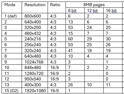

These are the current screen resolutions, along with how many pages of graphics you can have for each.
The classic modes such as 320x200 are fantastic for game development because you can have 25 pages at 16-bit, and being much lower resolution, the blitting is really fast.
The current widescreen modes use significantly more memory (higher resolution) and therefore don't have much in the way of sprite/buffer pages.

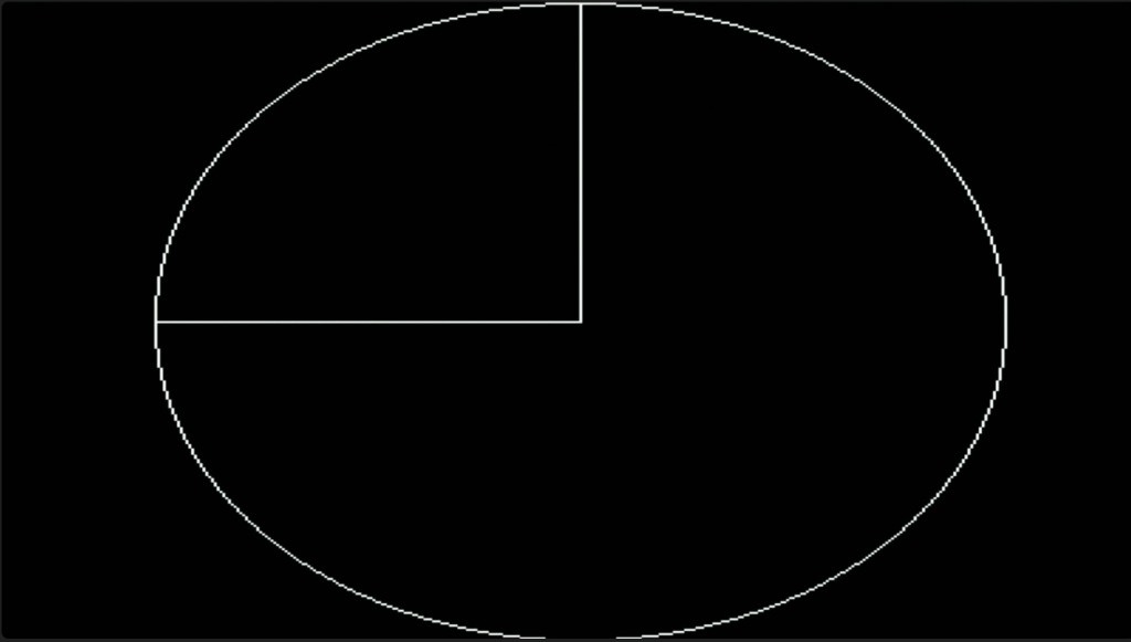

However, if I use the lower resolution screen on my widescreen monitor it gets stretched out like this (image below) which distorts any sprites especially if they are rotating.
Realistically most people won't have 4:3 monitors - so producing games for low-res widescreen makes sense (to me anyway).
Maybe something like 480x270 (quarter of 1920x1080)?

While awaiting another bowl of gruel, multiply all X values by a scale factor.
Eg.
CIRCLE 240, 160, 130 ,, 0.75

Thanks, but alas my issue is with sprites/tiles. The circle was just to demonstrate the issue. As they rotate, the non-square nature of the pixels elongates them horizontally.
