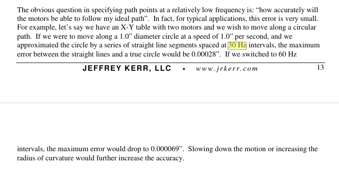

Machine moves are a different thing entirely:
In my case, machine-moves are incremented @500Hz.
