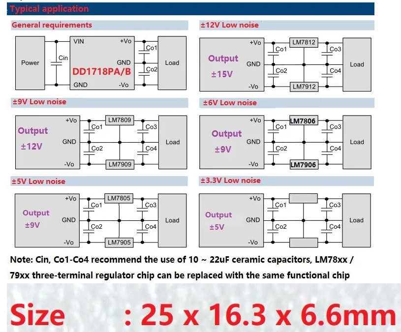

What would good alternatives be for this:
Posts: 2542
Posted: 03:12pm 16 Sep 2024
i'm assuming you are after something with isolated input and outputs, in which case one of the variants on this may suit:
https://www.ebay.com/itm/135119112375?var=434586673965
modules are 1" x 1" x 0.5" high. there are a whole load of different input voltage ranges, as well as (i believe) split output voltages. you'll need to have a dig around on ebay to find the exact one toy are after.
there are other (cheaper and smaller) modules that are a fixed input-to-output ratio with much lower current available and far less sophisticated design:
https://www.ebay.com/itm/334704382429
the above link is for 10 items. again, there are variants of these with split output.
i presume you need isolation between input and output?
rob   :-)

the 78 and 79 series of regulators are not obsolete, there are many many versions of them available, including precision, low dropout an many package options.
Just take a look at any of the major component suppliers.

Heck, even our resident human-database, Mixtel90 is under threat from AI
Thanks guys....can't believe it because I checked all the usual outlets and drew a blank.

Note that a LM7812 powered from 15v, also has 80% efficiency…
But yes, there are buck switchers that are 95%, andwith appropriate filtering also fit the footprint.
I use TI TPS54202 (sot23) a lot, they are 28v in, and produce 3.3v…12v at 1A easily.
Note also that the LM78 series is not a low noise regulator anymore. It may have been in the 1970s, but there are much better solutions now.

I am shooting for +-10v output from my DAC but what do I need on the OP-amp rails?
I was thinking maybe the +-15V (which is never perfect) regulated down to +-12V for the OP-amp?
It's not super critical actually because I can calibrate in software to not exceed 10V so I don't really need to do this...just feels good
The OP-amp is feeding a high-impedance input, BTW, so current draw is negligible.
Posts: 8973
Posted: 06:16pm 16 Sep 2024
To get +/- 10V swing your op amp needs higher than +/-10V obviously. However, how much more depends on how far that particular op amp can swing. The actual voltage isn't critical and it's stability should be such that it doesn't sag under full output swing but apart from that you don't really have a problem. Some op amps are ok with +/- 12V whereas others might need +/-19V. The spec sheet will give you a clue. +/-15V is pretty common as most op amps will manage to get two or three volts sway from the supply rails.
I'd say that even with a really good rail to rail op amp you need +/-12V to get a *linear* +/-10V out of it. Most will need +/-15V.
Your input voltage to the regulators needs to allow for the required headroom of the reg at the required current. You need to stay away from the dropout voltage but without having to dissipate more power in the reg than you need to.
Remember, the +/-10V swing doesn't depend on the supply rail voltage with an op amp. It depends only on the input voltage and the gain. The supply rails only have to be "big enough". You could have +13V and -18V - you'd still get +/-10V output if the op amp can get comfortably  within 3V of the supply rails.
