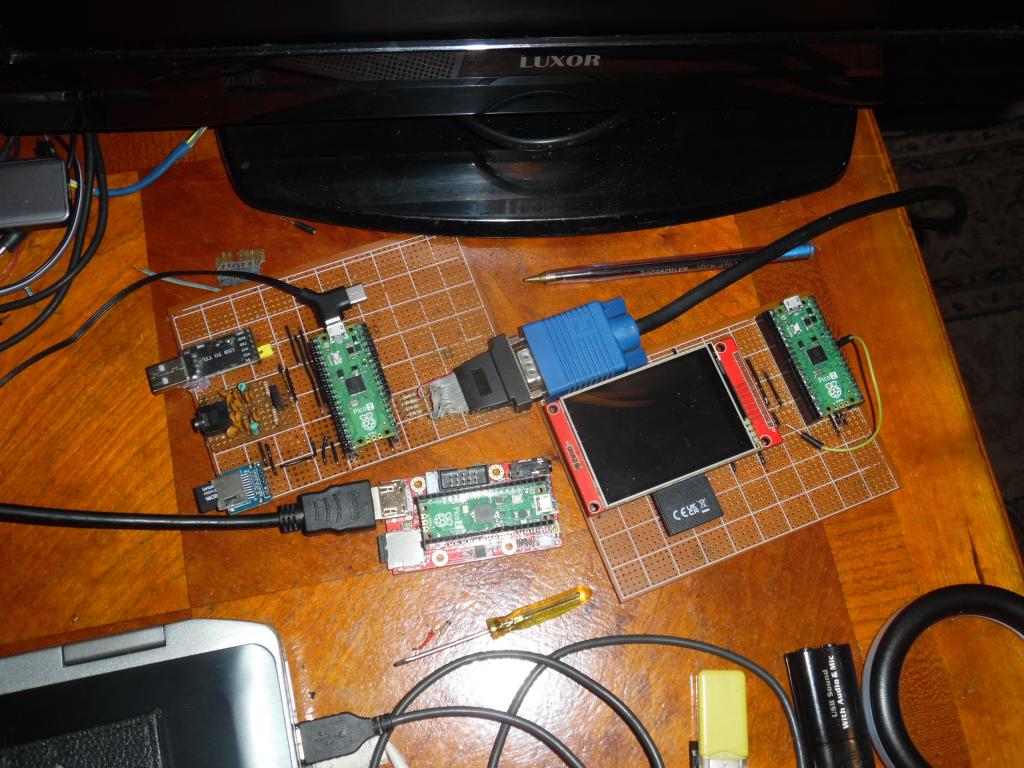

yes, pico2 hardware uf2 for what version.
I got usb vga , picomite ili9341 and olimex hdmi working.
drop in replacement for 2040? some stuff works.
Posted: 05:23pm 17 Sep 2024
using picomite lcd then all you should see is a speed improvement. not the spi display but the program.
frame buffers seem different.
same with existing vga programs.
olimex hdmi is something else but seems to be worth using with the support so far
