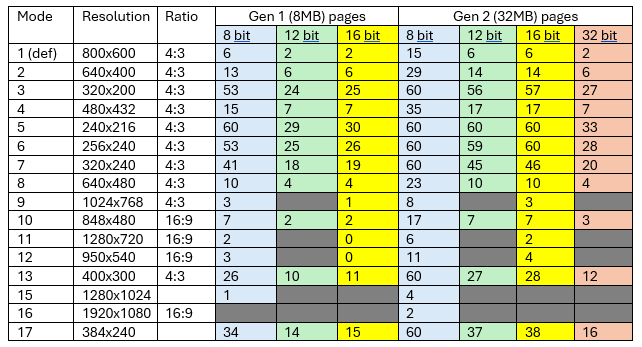

Now that I've got my hands on a shiny new 2nd Generation CMM2, I updated the cheat sheet I use for deciding which resolution I should write my games in. I thought that it might be useful to others as well - so here it is:
On the whole, there seems to be just over twice as many pages available for each resolution in Gen 2 (compared with Gen 1), up to a maximum of 60.
This opens up huge possibilities for pre-rendering graphics and creating some epic parallax scrolling. I am very excited.

Ah-ha...good info
I know next-to-nothing about the video capabilities but I saw your original table when I just started to look at the CMM2 and it didn't jibe with what little I knew about Gen 2. This makes sense now and looks pretty darned good.

No Biggie, Pete but I have been referencing this very useful chart
But the 32bit should be 24bit.

Thank you! I am very happy that you are finding it useful.
I expanded it into a mini cheat sheet that I keep next to my CMM2 to remind me of the major syntax and keycodes that I need for programs.
