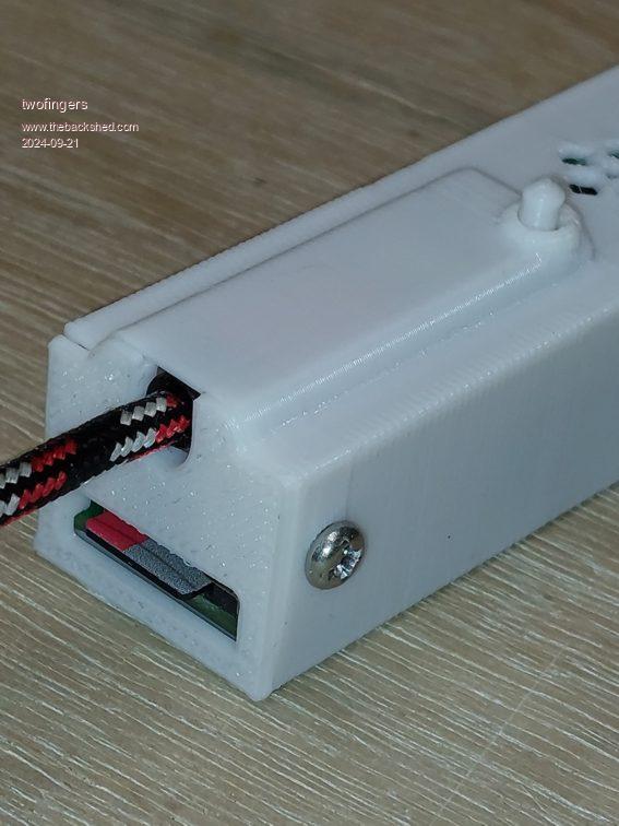

A 3D-printed case for the Picomite HDMI and Peter's adapter board (supplied by Plasma).

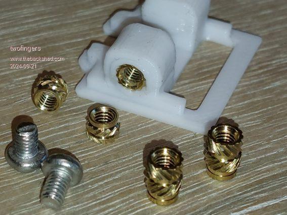

The required components are the printed two (or three) case parts, two M3/3mm threaded screws, and two M3 hot melt insert nuts, h=6.0mm, OD=4.6mm, core=3.9mm (or M3x3x4.5).
If you don't like hot melt insert nuts, there is also a version for sheet metal screws.

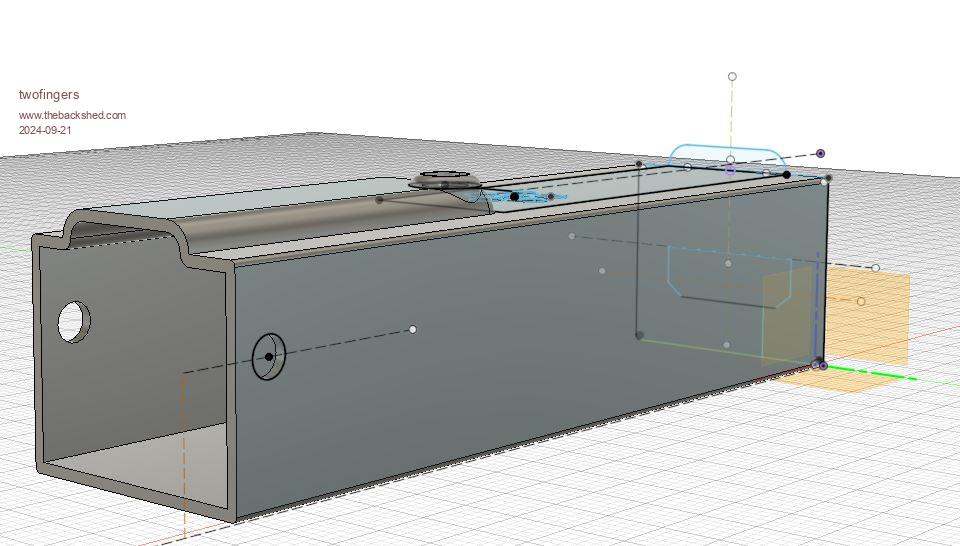

thx Michael , fusion 360?
Plasma
twofingers
Joined: 02/06/2014
Posts: 1782
Posted: 09:38am 22 Sep 2024
  Plasmamac said  thx Michael , fusion 360?
Yes, it is always good to keep practicing.
