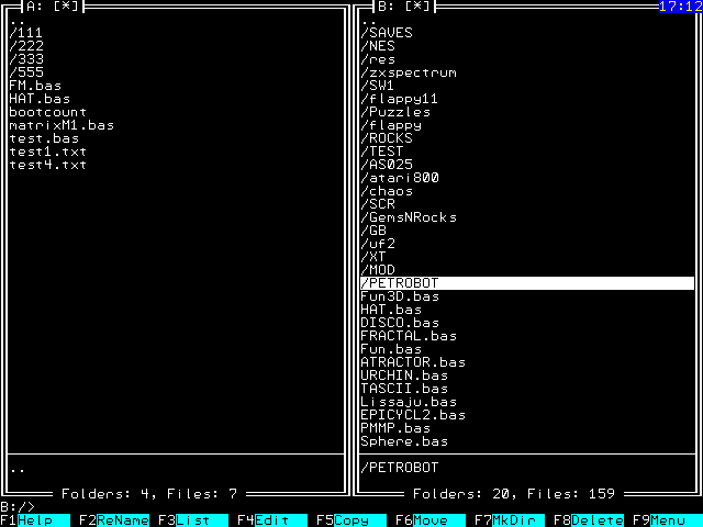

I propose here for discussion the topic of creating a File Manager program for PicoMite.
I would like such a File Manager to be built into the system and called by a command or a functional button, to work both in the terminal and on displays in different resolutions.
I think that such a software shell would be useful in the development and use of PicoMite.
As an example, I give here my attempt to create such a program for PicoMiteVGA (MODE 1), it is not quite finished, but you can already use it.
FM - File Manager.zip
Best regards, javavi.
