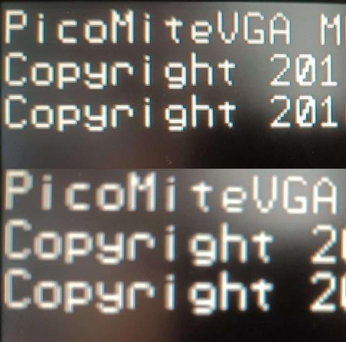

with PicoMiteVGARP2040V6.00.00RC1 there is quite strong blurr at left  part of screen (about 8-10 symbols and then it gradually starts to be clear) comparing to PicoMiteVGAV5.08.00
I tried to take better photos, but with mobile it is quite hard to do. (looks like it is mobile misfocus. It is slightly, but it is blurr between two versions too. Maybe I could try to filming that with stable camera and change firmwares) It seems to me I`ve seen this problem once before too. Same happens with USB version
Moving monitor`s H position blurr also moves

Posts: 11662
Posted: 11:16am 29 Sep 2024
What cpu speed? Does it make a difference?

On writing this post after, firmware upgrade, CPU speed was 126000 changed to 252000 but still gradually and unpleasantly blurrs

  Quote  On writing this post after, firmware upgrade, CPU speed was 126000 changed to 252000 but still gradually and unpleasantly blurrs
Can't replicate - rock solid clear for me. Have you tried auto adjust on the monitor?
Oh, Peter. As always we, users , forget stupid simple things.
I believe You already said once to me, but seems years and bad habitats made my brain dull.
Yes, autoadjustment made it excitingly clear everything.
Maybe it would be usefull to add some kind of trouleshooting Q/A into manual and start collect different user level problems, like, "Autoadjust your monitor IF blurred " and "Use another archiver IF black display after upgrade" etc. etc.
This way your precious time would be saved to some degree.
Thx for your wonderful work.
