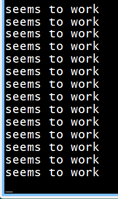

First time
Phone to ESP32 to PicoMite
I am such an awesome c-programmer

Oh wait...this is too much FUN!
I wanted to do an OnTimer (settick) equivalent.
I don't subscribe to ChatGPT and so I exceeded my daily limit.
Decided to try Copilot for the first time which when asked, informed me that there was no limits for coding help.
So, it started-off with some crappy external library...all kinds of errors and so it said let's stick with the built-in functions. It kept getting the function names slightly wrong and so I would change them. It really was like working with an extremely patient human and the more I assisted, I swear, it got excited
Well we got there and I'm kinda happy that we had to jump through a few hoops because it was just FUN
hw_timer_t * timer = NULL;
void IRAM_ATTR onTimer() {
 Serial.println("Timer Interrupt Triggered");
void setup() {
 Serial.begin(115200);
 // Initialize timer with frequency of 1 Hz (1000000 microseconds)
 timer = timerBegin(1000000);
 timerAttachInterrupt(timer, &onTimer);
 // If timerWrite works without issues, let's use it
 timerWrite(timer, 0);
 timerAlarm(timer, 1000000, true, 0);
void loop() {
 // Your main code here
