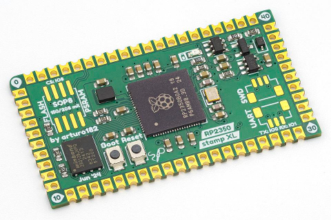

Has anyone looked at or bought any of these?  Any thoughts or observations?
https://www.lectronz.com/products/rp2350-stamp-xl
Warning!  2mm pitch pins, not breadboard friendly!  But there is a spot to solder PSRAM on.  Hmmmm  I wonder if it will run at the higher clock speeds?  (>315MHz)

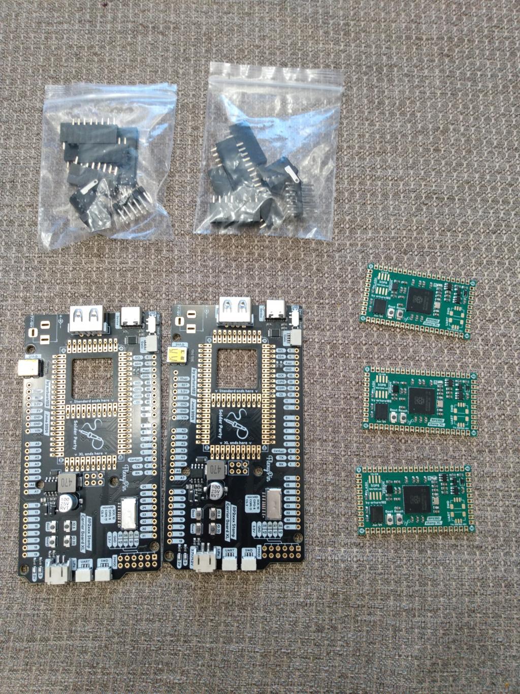

Mine arrived yesterday.  12 days economy snail-mail from Lectronz in MALMO Sweeden to Colorado USA.  I also ordered two of their "Stamp Carrier XL" boards.  My micro HDMI cables should arrive today. I should have some time to assemble and test tomorrow.  I also have some PSRAM IC's to install and test.  I don't know yet if these boards will run at the clock speeds required for the higher resolution HDMI modes.  I'll post here on TBS when I have more info to share.
Perhaps the name "Solder Party" refers to the 60 pins on the stamp XL device?  LOL

Ok, some initial results on the Solder Party RP2350 Stamp XL:
Device is stable at 315MHz (HDMI Resolution 640)
Seems OK at 324MHz (HDMI Resolution 1024)
Will NOT run at 372MHz (HDMI Resolution 1280)
I will do some longer term testing to verify stability at 315 and 324MHz.
Other observations:
The HDMI works fine with the default pin settings.
The SD card slot on the carrier board requires OPTION SDCARD GP9,GP10,GP11,GP8 which may require OPTION KEYBOARD DISABLE on non USB Picomite versions
The onboard LiPo charger and regulator seem to work OK.
The Official Pico2 is a great value at $5.00  but I still want a RP2350B device with more I/O pins.  The only RP2350B device that I have that runs reliably at 372MHz is the Pimoroni Pico2 Plus with the PSRAM removed.
All is not lost, I want to try the Solder Party module with my SSD1963 displays.  One of the nice things about the RP2350B is that the extra I/O pins will run a parallel LCD with plenty of I/O left over.  My best recollection is that the PicoMite firmware only supports 8-Bit parallel mode due to the limited I/O of the RP2040 device?

Ok, finally got the PSRAM installed and working:
Added the PSRAM chip to the Stamp XL.  The Stamp XL module has the PSRAM CS line tied to GP8.  The carrier board has GP8 tied to the SD-Card CS line.  The PicoMite firmware uses GP8 for PS-2 keyboard or console by default.
Had to cut the trace between GP8 and PSRAM CS on the XL module to get anything to boot.  Added a bodge wire between PSRAM CS and GP47.  I can hook up my el-cheapo USB microscope and take some pictures if anyone is interested.
Now it boots, and the PicoMite firmware recognizes the 8MB of PSRAM with OPTION PSRAM PIN GP47.  Haven't had much time to test the PSRAM, will need to write a small program to test.
The RP2350B still seems stable at 315 and 324MHz  with the 1024 resolution modes still a bit marginal.
