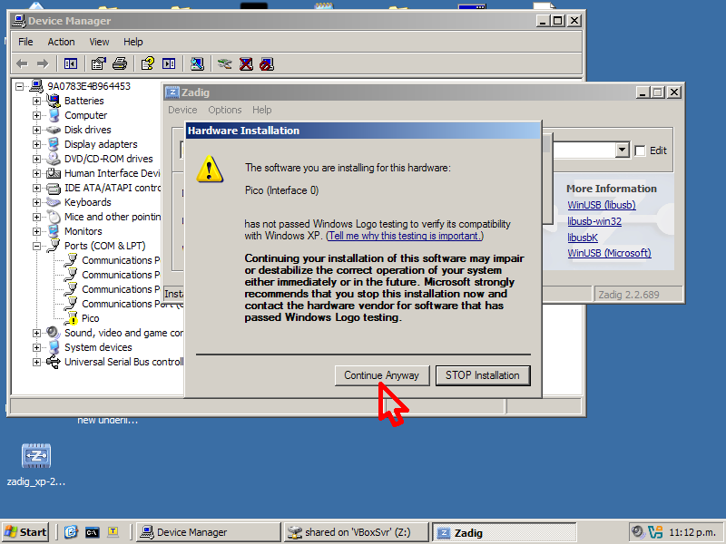

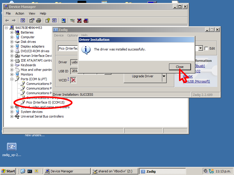

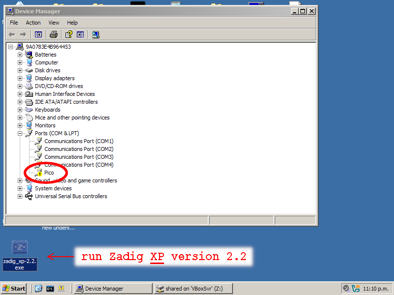

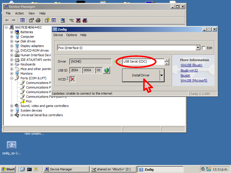

to answer Michael's initial question, download Zadig XP version 2.2 from here:
https://zadig.akeo.ie/downloads/
and then follow these slides:
note in the second slide to select USB Serial (CDC) in the dropdown.

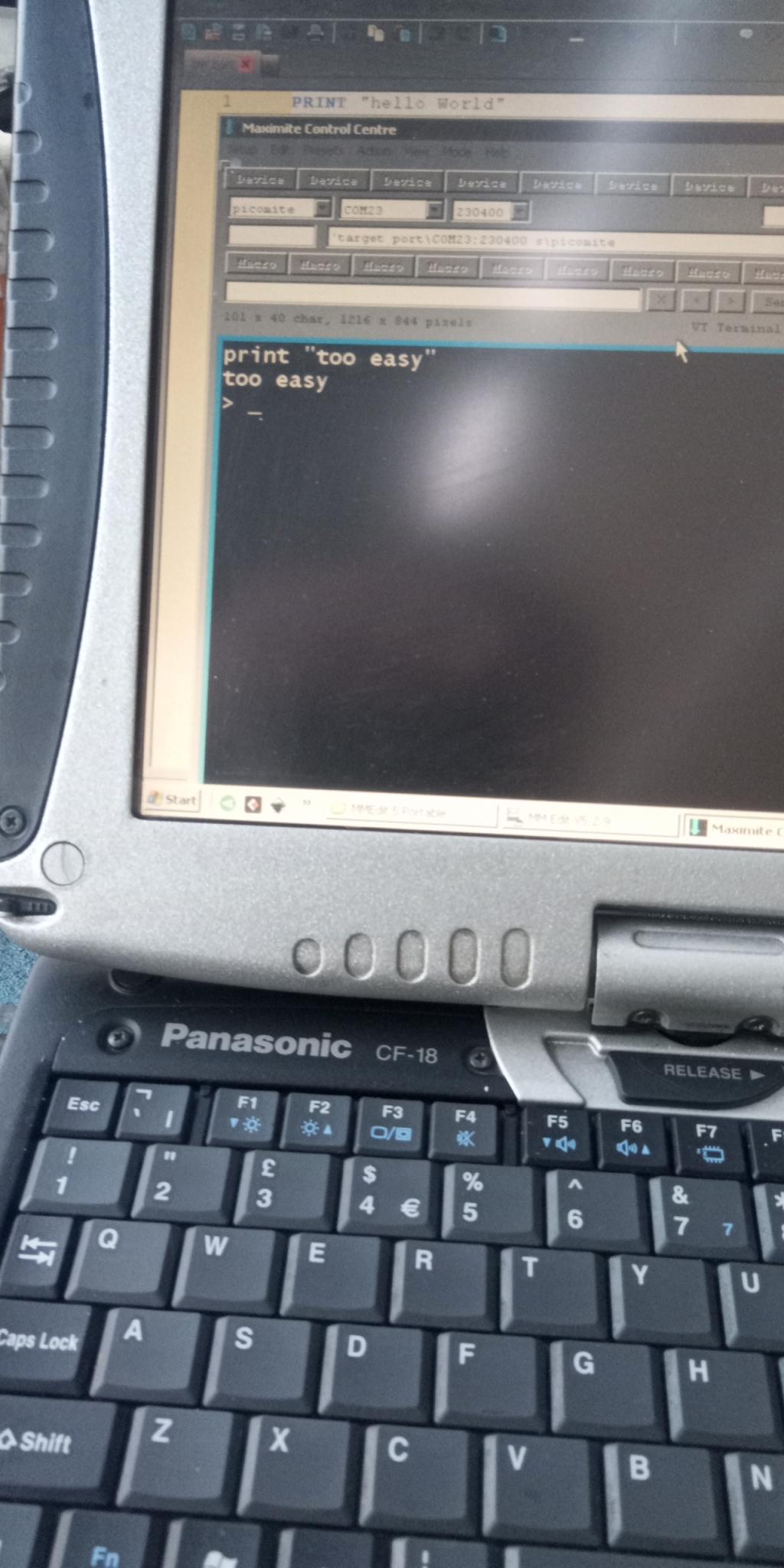

OMG....that must've taken all of two minutes
Many, many thanks, Rob
