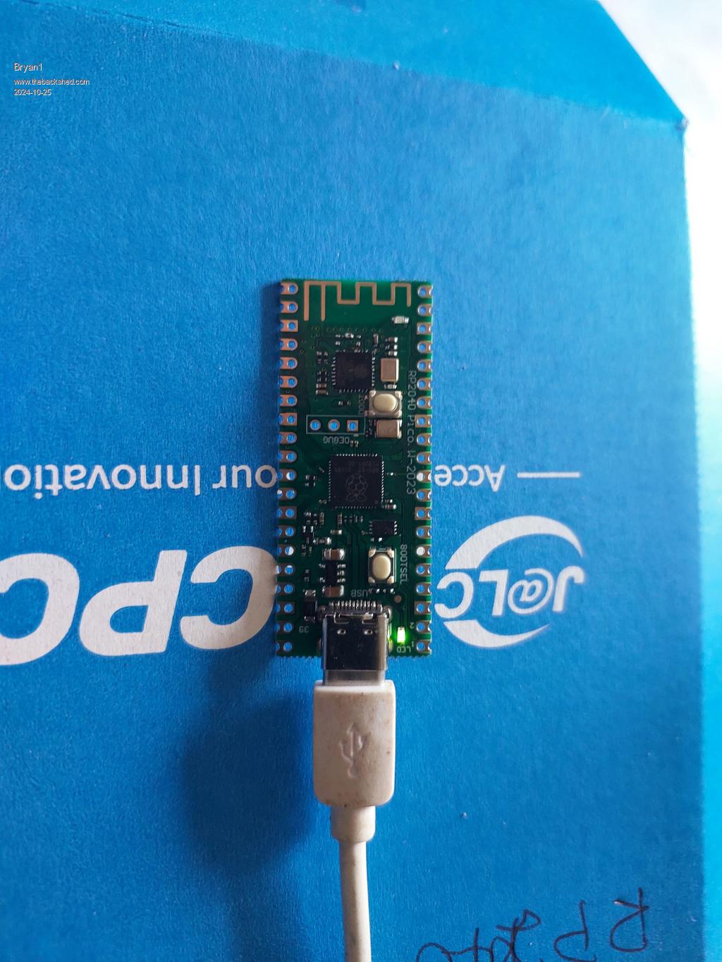

Now here is a pic of the picoW
Posts: 3369
Posted: 03:44am 25 Oct 2024
I don't know what board you have there but it is NOT a Raspberry Pi Pico W.
Posts: 3412
Unfortunately I don't think that is a PicoW.
The PicoW WiFi module has a metal shield, the antenna is different and it has a micro USB socket, not USB C.
Check the sellers description of it.
Core Electronics has the genuine article.
Edit
If you can't get your money back you might be able to load standard PicoMite firmware on it.
If so most of the pins may be usable for other things. Trial and error to see which GP numbers are devoted to the RF chip and thus not usable.
Edited 2024-10-25 13:52 by phil99
Bryan1
Joined: 22/02/2006
Posts: 2297
Posted: 03:50am 25 Oct 2024
Well thats Ali for you now this one has the ESP8285 chip and when I did the Ali search I just used used PicoW so looks like back to Ali to find the right one.

So decided to look at this board and found this. So the antenna isn't even connected
Well I did search for a PicoW on Ali and it seems many on the rpi forum did as well
