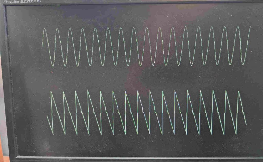

Specially for Harm
Coming in RC10 I've unlocked the ADC speed and it can now sample up to CPU speed/96
So in the example below on a RP2040 I'm running the CPU at 378MHz and sampling two channels each at 1.96775 MHz to give a total sample rate of over 3.9MHz
https://youtu.be/7w7MKo9nofo
CLS
FRAMEBUFFER create
FRAMEBUFFER write f
Dim float a(1279),b(1279),aa(639),bb(639),c(639),d(639),e(639)
ADC open 1968750,2,done
For i=0 To 639:e(i)=i:Next
ADC start a(),b()
Loop Until f%=1
f%=0
p%=Math(crossing a(),1.5,-1)
Memory copy float Peek(varaddr a(p%)),Peek(varaddr aa(0)),640
Memory copy float Peek(varaddr b(p%)),Peek(varaddr bb(0)),640
Math scale aa(),50,aa()
Math scale bb(),50,bb()
Math add aa(),50,aa()
Math add bb(),250,bb()
Line graph e(),c(),0
Line graph e(),d(),0
Line graph e(),aa(),RGB(green)
Line graph e(),bb(),RGB(cyan)
FRAMEBUFFER copy f,n
Math scale aa(),1,c()
Math scale bb(),1,d()
Sub done
f%=1

Hi Peter,
Looking at the saw-tooth waveform it looks like the ADC silicon problem amplifies when you sample faster. Thanks for providing the option.
About Scoppy. You could build a system with an additional build in Pico-W (if you can spare the extra 100mA) that is always available. For diagnosis you would only bring your phone to the site, and connect to the pico-w and diagnose. Even if the system is on top of a mast. Sounds like a solution for some projects. Maybe it is not if you think about it deeper. IS this a solution looking for a problem..? Maybe..
