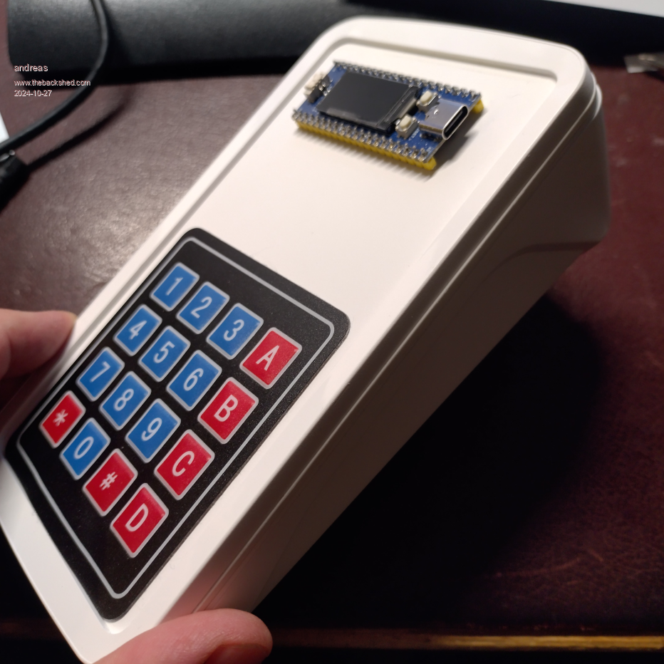

Build a "programmable calculator" ;-)

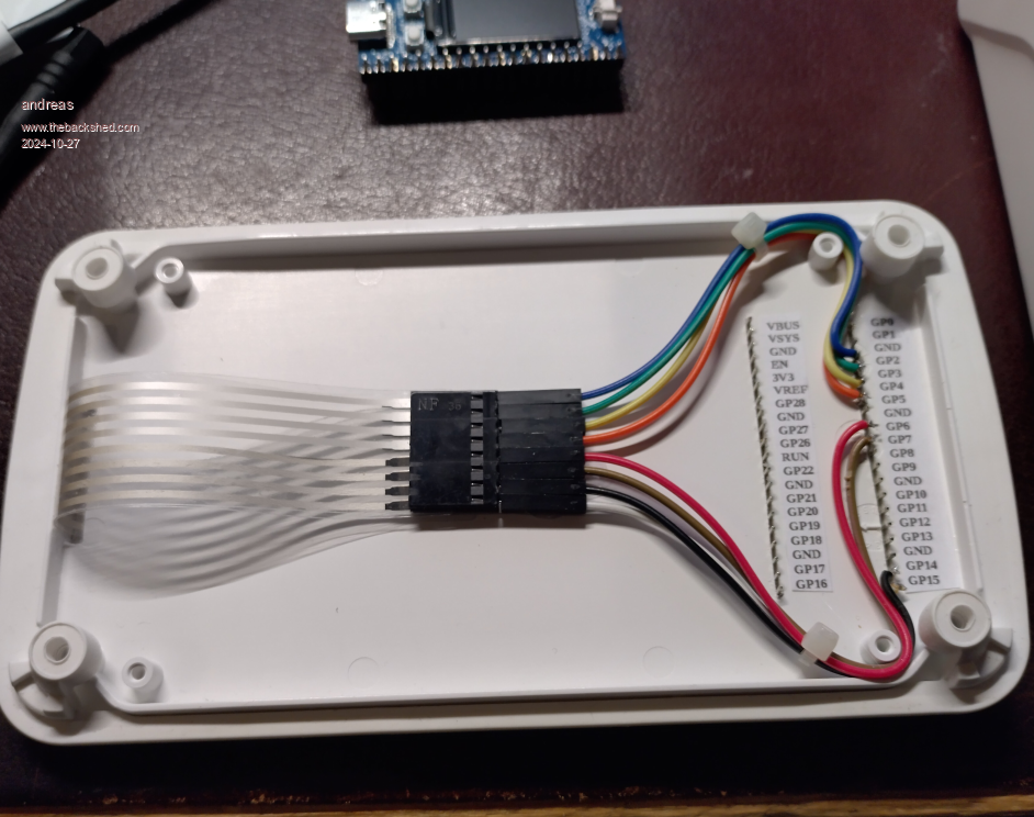

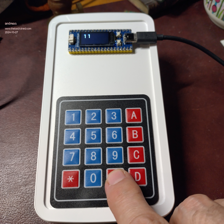

Everything it does: connecting a RP2040-LCD with a keypad. Programming is up to you!
Just an inspiration
' keypad
CLS
Text 10,10,MM.Info(device)
Device KEYPAD Taste,myint,GP15,GP14,GP7,GP6,GP5,GP4,GP3,GP2
Font 5
Sub myint()
 Print "Taste = " Taste
 Text 10,10,"       "
 Text 10,10,Str$(Taste)
 Pause 1000

Good ideas! The box is large enough to build in all these ideas.
My primary reason to setup this calculator is the game "Hare and Hedgehog – Game of the Year 1979". There you have to calculate the number of carrots to move from a starting field to a destination field. Even better would be a calculator which tells you how far you can reach within 2 or 3 or 4 rounds or what will be the "best move" to reach the final destination as quickly as possible. So I will use it as a "carrot-calculator" & "gaming-advisor"
