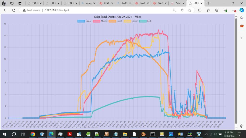

I'm using the INA226 with Annex, monitoring some miniature 18V 1A solar panels to see what wintertime shading is like in the hopes of someday mounting real panels.
Here's a graph:
I am not confident that I have the calibration correct, but for my purposes, it doesn't matter--the comparison over the day is what is important for this exercise.
Write-up here
