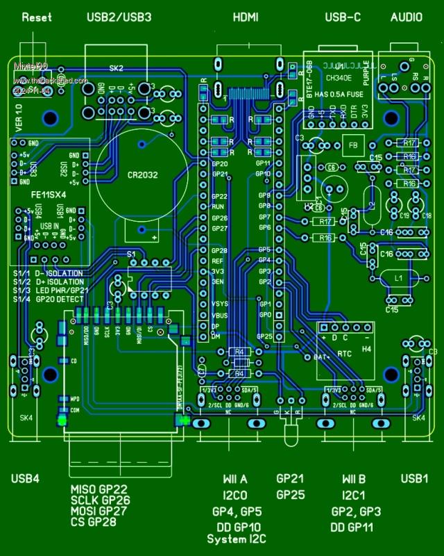

Just for fun. No apologies, this is only intended for gaming. :)
This isn't a completed design, obviously, but it brings together some ideas I've intended to try.
Uses the new 44-pin version of the Pico 2. :) Add 2 extra pins on each side to connect D+, D- and GP25. You can restore it to normal later by taking your link wires to the TPs off and snapping off the extra pins.
The WII sockets support the DD pins so detect them going high to see if a controller is plugged in. (I need external pull down resistors, forgot - sorry).
Uses a 4-way DIL switch.
1 & 2 isolate D+ and D- while installing MMBasic.
3 overrides the GP21 signal to the LED, making it indicate Power On.
4 pulls GP20 low. It could be used to, for example, instruct an auto-run program to abort while testing it. There must be other uses. :)
If switch 3 is off you have full control over the LED. The Red side is fed from GP25 and replaces the heartbeat. The other side is fed from GP21. You can PWM these or whatever. I have some Red/Blue LEDs now which are rather nice. :)
The WII connectors are a little close together really, but just about manageable, I think. I can't get them any further apart without having to use a micro SD socket. You don't escape SMD soldering anyway as the HDMI socket is SMD as are its 0805 resistors.

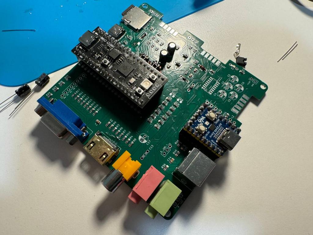

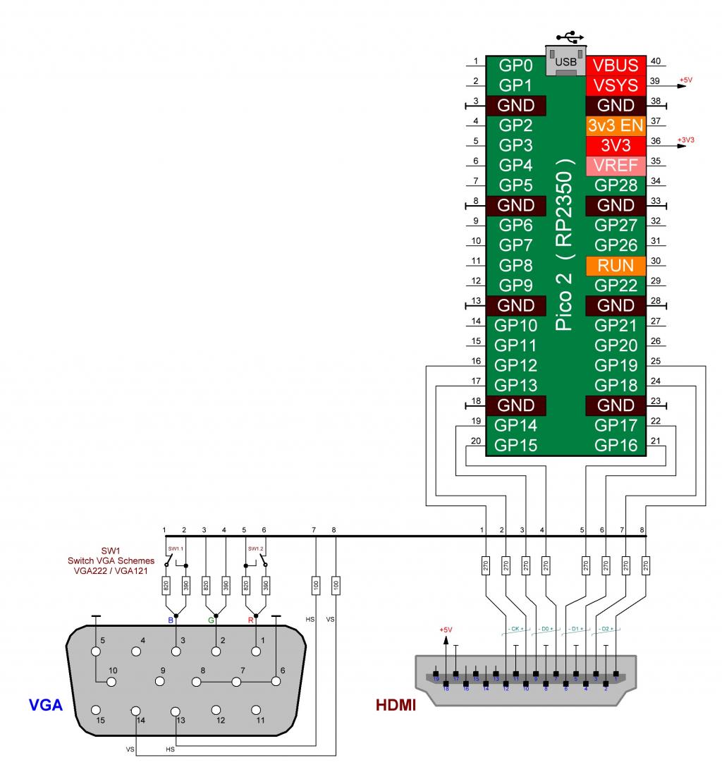

You can also try to fit a VGA video output there, connected in parallel to the HDMI with its own resistors.
This solution has already been tested in other projects and does not interfere with each other's work.
Also implement a VGA color bit depth switch VGA121/222 for the VGA, which will make it possible to port many console emulators to this board.

Talk about the minimum length of the HDMI tracks on the board is untenable since the cable is much longer, here it may be a matter of their identical length, but it is not so critical.
Yes, in the dimensions of your case, perhaps everything will not fit, I would just like to get a universal design that could work with both VGA and HDMI video output.
Once again, I inform you that such a solution with parallel connection of two video outputs to Pico2 has already been tested and works fine. There is also a way to automatically detect the type of connected video interface when starting the program based on the state of the input ports.

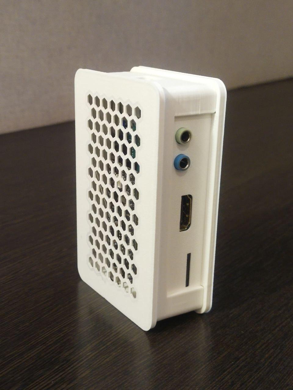

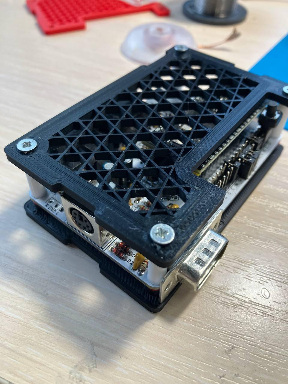

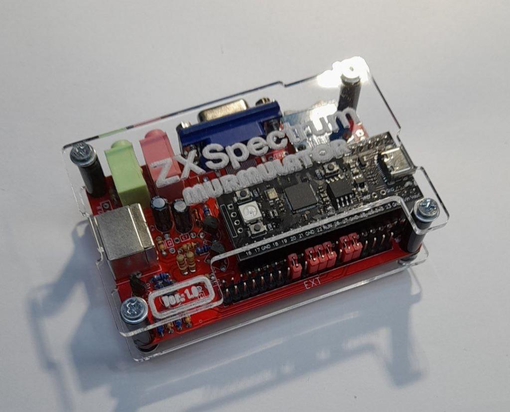

Do you have to use a ready-made case for this device? With a ready-made case, you are limited to its two sides and the internal screws for fastening the board.
It is possible to develop a case model for printing plastic on a 3D printer, or for cutting acrylic on a laser.
This is how it might look, normal for an amateur design.
Edited 2024-11-05 00:40 by javavi

@javavi: I know the murmulator (actually I think there are more than one design. This one looks different from my memory). It is extremely compact. But...
This is just my taste.. I like designs that have all IO in front and back. And for me there is no requirement for "small". A shoe-box size (lower profile) is okay as well. I am not stocking so many that I need a big shelf. One or 2 is enough. Although.... with current changes I have to decide on a platform to continue with. There are so many options (VGA/HDMI, PS2/USB, WII/USB controller, PWM audio/DAC/VS1053, SD/uSD, 2040/2350)..

It looks like you already have a design. :)
Have you seen a system with two sockets that works or has it just been a design that has been done?
No idea how that YD-RP2040 could generate DVI/HDMI though. It won't overclock to that speed. Mine die at just over 250MHz. They only just make it to VGA. lol
I never use custom cases. I can't make them and it's not economic to get them made in one-off quantities. They are really nice, but just not practical for me personally.

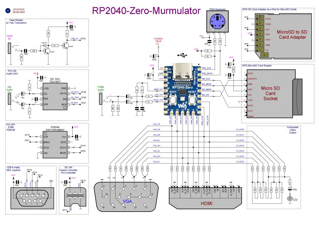

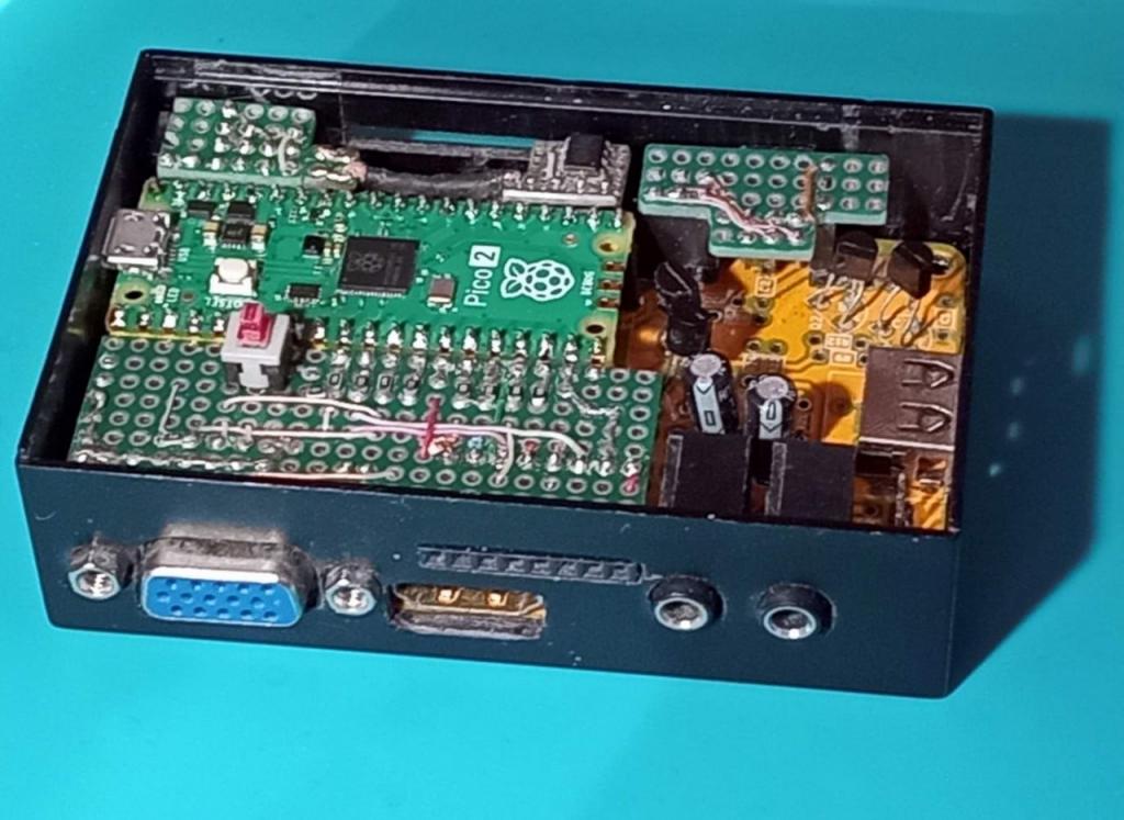

  Mixtel90 said  Have you seen a system with two sockets that works or has it just been a design that has been done?
Here are some examples, there are others. True, HDMI here only works with a resolution of 640x480, but with sound.
In parallel to the HDMI, VGA and even a composite video output are connected.
Edited 2024-11-05 01:43 by javavi

The 220R or 270R resistors in the HDMI signal paths at the Pico end don't help the impedance matching in particular. In fact they make it worse. They are current limiters to protect the output drivers in the Pico The terminating impedance is 50R per line, 100R across each pair. This would take about four times the current that the Pico could source while supplying a usable voltage. In order to supply some voltage into the line it's necessary to limit the current and hope that we can get away with the impedance matching!
This doesn't affect the phase of the signals reaching the monitor, although it makes a mess of the wave shape. We still have to supply the data signals in phase with the clock so we can't introduce delay lines made from capacitors to GND and very unmatched trace lengths. We can get so far, as I've proved with Alpha, but just how far out we can get I don't know. This is why I've never attempted to fit both VGA and HDMI to the same board.

If you have the 220 ohm resistors close to the PIO pins, vga and hdmi will not be affected much.
But you can never plug both.
