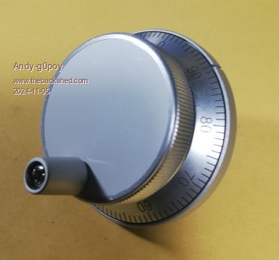

I have been trying to get this higher quality encoder working, it's sold as for use
with CNC machines. It is a really nice dial.
It outputs the normal quad. phase signals, but it is slightly different to the KY-040
in that the phase of the outputs is always 90 degrees apart.
The encoder is an optical type, so no contact bounce to worry about and
it outputs 100 pulses per rev.

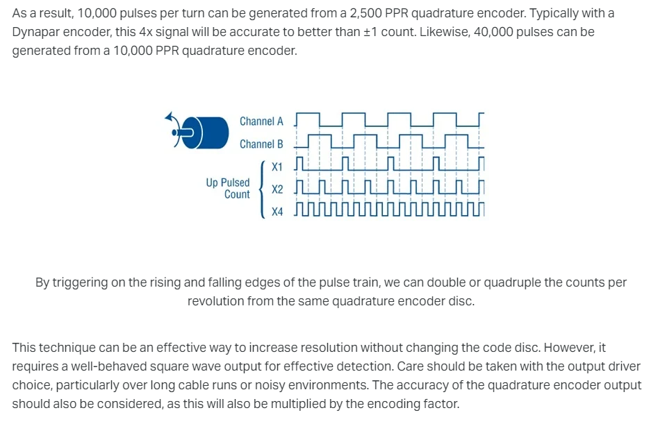

If that's a 100 line encoder, you will get 400 quadrature counts/revolution
Here, the frequency is 63MHz. Divide that by 44 and the count rate ~1.43M counts/sec.
Works beautifully.

  Andy-g0poy said  Thank's both.
I never considered that the count input might be useble, worth a think about.
Andy
Counting pulses is one thing but the phase offset between CHA & CHB indicates direction (up/down).

I just came across an app note on my PC that might be of interest for non-PIO encoder interfacing.
an-1011.pdf

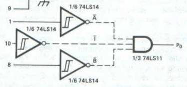

@Volhout
FYI: For best possible precision, the index is gated with A and B:
(apologies for the poor quality)
