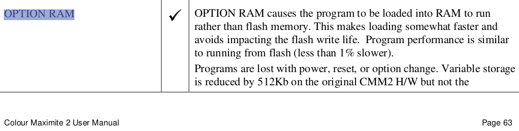

and what does this mean in my case? When I "run" a program stored in the filesystem A:\ is this a RAM operation or does "run" mean: write something into flash?
I write the programs only once but will run them many times - is the running of a program using up flash or is it an RAM only operation?
I remember a OPTION RAM instruction on the CMM2 to prevent degradation but the pico has no OPTION RAM, isn't it?
-andreas

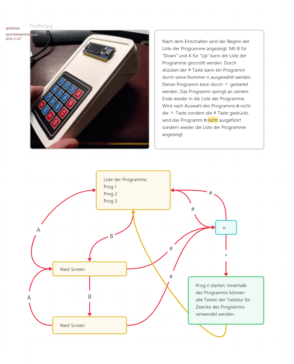

I plan to write a kind of program-selector for my "picopad". The programs will be independent - so they don't need any common variables. Every program will have a final line calling the top-level menu to select the next program to start. the top-level program will just start the program selected. So it will be a large menu and many independent programs without common variables.
Sorry for the German text - it was generated with obsidian for myself only but could possibly show what I intend to do? It is a kind of state diagram.

Posts: 9222
Posted: 07:48pm 06 Nov 2024
When you run a MMBasic program it can have a file$ and a commandline$. So in theory you can have:
In the menu program:
RUN "Myprograms","200"
When Myprograms.BAS runs it can use
GOTO MM.CMDLINE$
200:
'do a program here
GOTO LEAVEIT
LEAVIT:
RUN "MENU"
I've not tried this, but it looks like it should work. :)  You can put a lot of small programs into one big one in this way. FLASH RUN doesn't take a command line argument so it becomes more complex to do this sort of thing. I've usually had to resort to VAR SAVE.

FLASH RUN n or FLASH CHAIN n will run the program from where it its currently stored and not touch the program memory  (which is flash)
RUN by itself will run the program in program memory and is only a read operation.
RUN filename will copy the program to program memory (flash) and run it there.
So every RUN filename will be a flash write to the MMBasic flash program memory.

Shock in the morning
I start missing the OPTION RAM of the CMM2 in PicoMite! Would be nice to have an OPTION not to copy something from flash to flash (RUN filename) but from flash to ram for execution.
-andreas

  matherp said  If you are using the run command to swap between programmes then you are wearing out the flash memory. To do this sensibly load the two programmes into flash slots and use the flash run or flash chain commands.
Hey! How about an OPTION RAM (the CMM2 style;)
-andreas

There isn't enough RAM in a PicoMite to have an OPTION RAM command. It appears that I was naïve in thinking that it had enough to run programs from there!
The CMM2 is a different beast entirely! Quite a lot of RAM and extendable.
Use the FLASH, Luke...  ;)

I planned to have larger number of programs than there are flash slots, so your method of using SUBs will be the only possible way...
I have already programmed a library for Input (from the keypad) and Output (to the RP2040-LCD). The Input is represented by a 'LastKey$' Variable defined and updated within the library and output is realized by two commands 'Show' and 'ShowTab' which put either a single line of text into a dedicated display line with a dedicated color or put a 2 x 3 table of six strings, predefined colors and some framing on screen.It looks nice and works already well. The library is really important to make all this working and hide the details of input and display from the application programs.
-andreas

You could use the menu selections to point to a "jump table". Each entry in the table points to the "address" of the program (i.e. a label). At each label location there is either the program or a FLASH CHAIN to point to it.
That makes the menu items nice and easy to maintain. You can change their destinations in the jump table without moving programs around, you can replace one program with another - even if it's in the other flash slot - permanently or temporarily without disturbing anything. You can work with numbers from the menu selection and the "jump table" converts them to label strings. It could be DATA statements.
