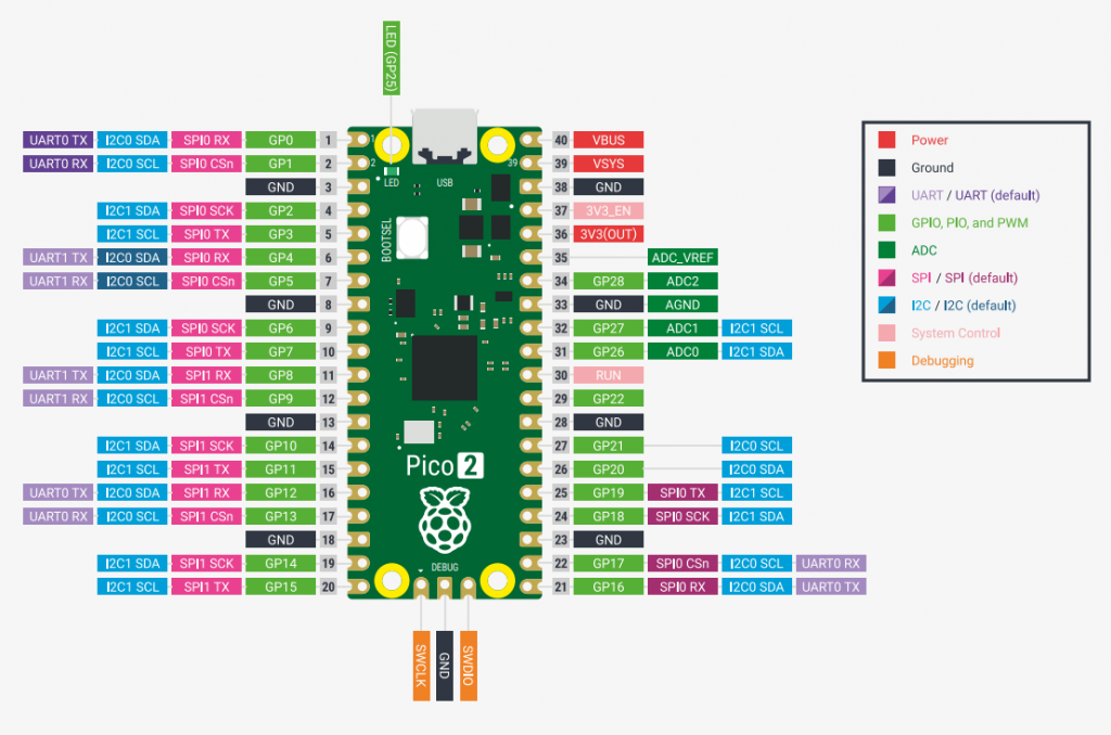

Posted: 11:01pm 16 Nov 2024
what are adc pins 2350 but on olimex hdmi? please

Posts: 3412
Posted: 11:43pm 16 Nov 2024
  Quote  Error : Pin 31/GP26 is reserved on startup
OPTION AUDIO GP26,GP27', ON PWM CHANNEL 5
Try GP28
Posted: 12:49am 17 Nov 2024
Try GP28
RUN
[9] SetPin (28), AIn
Error : Pin 28/GND is invalid
Posts: 3412
Posted: 01:10am 17 Nov 2024
  Quote  Try GP28
SetPin GP28, AIn
or
SetPin 34, AIn
Edited 2024-11-17 11:33 by phil99
Posts: 12035
Posted: 08:20am 17 Nov 2024
  Quote  what are adc pins 2350 but on olimex hdmi?
There aren't any with audio enabled. Without audio enabled and the link between GP28 and GP26 removed you can use GP26

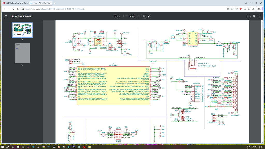

Posted: 07:17pm 17 Nov 2024
Mick, you seem more informed about olimex board than me. I don't know why gp26 and gp28 need joining.
If I made a hdmi usb 2350 board then no problems? sound and adc work like usb vga 2350?.. which not tested adc.
how to wire hdmi to 2350, need a header and resistors?
Posts: 9222
Posted: 07:48pm 17 Nov 2024
MMBasic's audio wants both channels to be on the same PWM, where they use A and B outputs. GP26 and GP27 would be fine for this as they ae on PWM5. The Olimex board has used GP28 (PWM6A) and GP27 (PWM5B) for audio and put GP28 on the DVI_CEC signal.
This seems a weird choice. Why take the A channel from one PWM and the B channel from another? In fact, the whole of the audio side is odd. They took the PWM output, put it through a logic buffer then fed it into the simplest RC filter that was first used on the Micromite (except that they took the DC off the output). They put some resistors in to run an extra buffer too but then disabled it. Very strange and they don't seem to have gained anything.
By linking GP26 to GP28 you are getting the right channel from GP27, the left channel will appear on GP26 which is then linked to GP28 so that it can appear as audio.
The audio connections for the RP2350 and the RP2040 are identical when running MMBasic.
