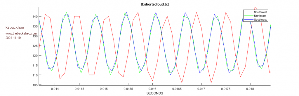

Here is a MATLAB plot of a 1628 Hz signal converted at 10kHz sampling rateon all 3 channels with 2 channels shorted for testing and with the 3 channels offset in time by 0 uSec, 33 uSec and 66 uSec to properly align ADC1 and ADC2:
