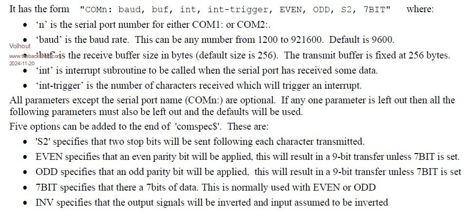

Hi Tom,
Opening serial ports:
MMB4L synctax is similar to picomite. Only you use /dev/ttyUSBx in stead of COMx, and lacks the INV option. B.t.w. I run MMB4L at 921600 baud and no issues.
DOS MMBasic tries to mimic MSDOS/GWBASIC syntax, that is strict in single character definitions.
MMB4L:

Posted: 02:20pm 19 Nov 2024
Is the part "If any one parameter is left out ..." correct?
I'm thinking it ought to be OK to omit params so long as the right number of commas are used for MMB4L to cope.
Posted: 02:35pm 19 Nov 2024
  JohnS said  Is the part "If any one parameter is left out ..." correct?
I'm not sure, and to be honest I'm not going to test it just at the moment when there is only one user other than myself who seems quite happy . The difference may be that the comspec$ is a string to be interpreted not a series of MMBasic language tokens.

Posted: 02:45pm 19 Nov 2024
No problem - I was just wondering if the manual needed correcting.
Posted: 02:55pm 19 Nov 2024
  JohnS said  No problem - I was just wondering if the manual needed correcting.
The image @Volhout posted is from either the CMM2 or PicoMite manual I think, though the MMB4L README says something similar: https://github.com/thwill1000/mmb4l/blob/main/README.md#open
