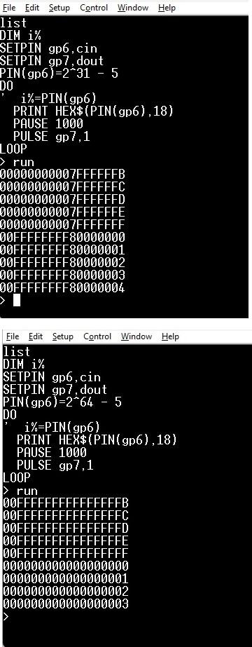

So using your idea I ran 2 programs ....
I'm printing 18 hex digits and it's pretty obvious that the counter is 16 hex digits or 64-bit ie the same as a signed 64-bit integer.

  Quote  it's pretty obvious that the counter is 16 hex digits or 64-bit ie the same as a signed 64-bit integer.
Your first example shows a 32 bit signed number going negative.
The counters are 32 bit internally but get changed to 64 bit when accessed.
The sign bit gets extended.

OK I see what you mean. If the counter was 64-bit then my first example would have gone
000000007FFFFFFD
000000007FFFFFFE
000000007FFFFFFF
0000000080000000
0000000080000001
0000000080000002
etc
But because the sign bit was extended after 7FFFFFFF it means it's a 32-bit counter but read as a signed 64-bit integer.
Thanks for the clarification, it makes a lot of sense now.

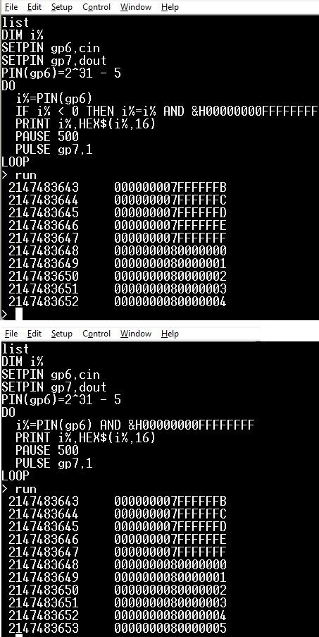

Back to the counter input - it seems silly to have counts go negative once it passes 7FFFFFFFH (2147483647). A work-around is to zero the upper 32 bits so the integer never goes negative. The following 2 examples seem to work:
Peter, for a future release could this be fixed so the count always stays positive? It would make more sense. Not sure what should happen if the count goes past max but with the programs above it continues counting from zero again.
