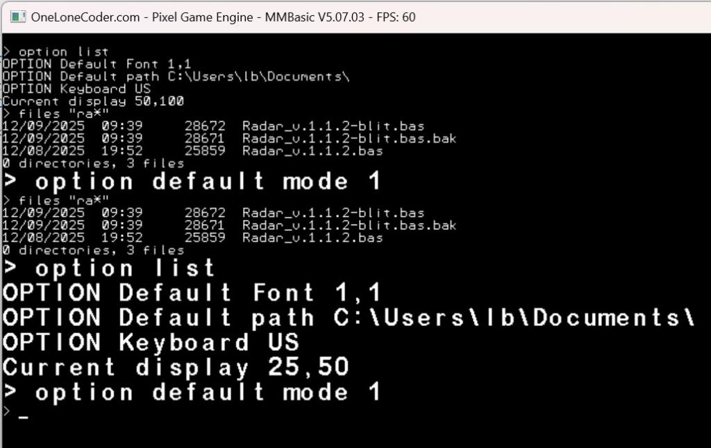

Posted: 05:45pm 11 Dec 2025
I also have a blank screen when starting MMB4W (exe dated 10/2/2025). OPTION DEFAULT MODE 9 still gives me a blank screen. OPTION DEFAULT MODE 16 (as elsewhere suggested) also does. OPTION DEFAULT MODE 1 works, showing me the prompt.
But if I issue "files", what I have asked for is listed, but the ">" is in a very large font. OPTION DEFAULT MODE 1 takes me back to what is expected.
Is there a way to start up without the blank screen (because I forget about the OPTION DEFAULT MODE 1 fix), and is there a way for "files" not to reset the mode?
