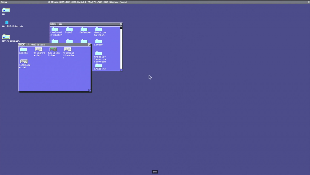

I know - The CMM2 already has a fully working file manager. But this started as a bit of fun. It was originally going to be a GUI for a graphical text adventure like the old Magnetic Scrolls "The Pawn" or "Guild of Thieves".
Then it sort of morphed into a front end for launching programs or managing files.
It's a work in progress, so it almost certainly has a few bugs, and there's a lot more features I want to add to it (Ram Disk, Networking etc.), but I want to spend time on some games dev, so it's going back on the shelf for the time being.
It happily handles files and directories being moved, renamed. Launching programs. Copying links for folders to the desktop (for easier launching) and it has a Rubbish bin for deleted files, so that they can be recovered.
It does require a CMM2 Gen 2 as it uses the mouse. It is by no means intended to be an operating system - I 100% still prefer that the CMM2 boots straight to BASIC and not to an OS. But part of my thinking was that if you did want to make a system that was easier for the grandkids to launch games etc. then this would suffice. It would be simple to disable the disruptive commands (Delete, Move, rename etc.) so that it was only a file launcher.

       C9_DeleteSelectedFiles
       IgnoreInterrupt% = 0:C7_CloseMenu:EXIT SUB ' The click has been handled - no need to go further
     ENDIF
   END IF
   IF GUIMenuParameters%(MENU_ID) = 2 THEN ' Desktop icon menu - Remove from desktop
     IF GuiMenuCurrentItem% = 0 THEN ' Remove from desktop
       C9_RemoveSelectedIconFromDesktop
     END IF
   END IF
 ENDIF
 C7_CloseMenu  ' If we are here, then the user clicked somewhere on the screen. If a menu was open, then close it
 DebugLine2$ = ""
 IF MouseY% < 15 THEN   ' Top of screen Menu Bar Click
   IF MouseX% < 40 THEN ' System Menu Open/Close
     C7_SystemMenuOpenClose
   END IF
   IF MouseX% > MM.HRES - 20 THEN ' Close program
     IF MM.INFO(EXISTS DIR OriginalWorkingDirectory$)=1 THEN
       CHDIR OriginalWorkingDirectory$  ' Remember to put the user back in the working directory they started from
     END IF
     CLS
     END
   END IF
 ELSE
   'Check if this was a window the user clicked on
   FOR I% = 0 TO 99
     IF WindowData%(I%,WIN_ID) <> 0 THEN
       WindowLeft% = WindowData%(I%,WIN_X):WindowRight% = WindowData%(I%,WIN_X) + WindowData%(I%,WIN_W)
       WindowTop% = WindowData%(I%,WIN_Y):WindowBottom% = WIndowData%(I%,WIN_Y) + WindowData%(I%,WIN_H)
       WindowHeight% = WindowTop% - WindowBottom%:WindowWidth% = WindowRight% - WindowLeft%
       IF MouseY% > WindowTop% AND MouseY% < WindowBottom% THEN
         IF MouseX% > WindowLeft% AND MouseX% < WindowRight% THEN
           DebugLine2$ = "Window Found"
           IF I% <> 0 THEN  ' Is this window topmost - if not make it topmost (Move to position 0)
             C4_MoveWindowToTop I%
             C4_ClearSelectedIcons   ' Unselect and selected icons - i.e. no icons are selected
           END IF
           WindowClickedOn% = 0   ' Topmost window clicked on (0 is always the topmost)
           ' Is it the windows resize icon
           IF MouseX% > WindowRight% - 15 AND MouseY% > WindowBottom% - 15 THEN
             WindowSizeChanging% = 0
             WindowClickedOn% = -1
           ELSEIF MouseX% < WindowLeft% + 40 AND MouseY% < WindowTop% + 15 THEN 'Did the user click on the back button?
             WindowPaths$(0) = C9_GetParentPath(WindowPaths$(0))  ' Move to the parent folder
             C5_UpdateWindowContents 0   ' Read the contents of the new folder from disk
           ELSEIF MouseX% > WindowRight% - 20 AND MouseY% < WindowTop% + 15 THEN
             'Did the user just click on the close button
             C4_CloseWindowWithIconId(WindowData%(0,WIN_ID))  ' The active window is always 0 - close it
             WindowClickedOn% = -1   ' No window selected
           ELSEIF MouseX% > WindowRight% - 10 AND MouseY% > WindowTop% + 16 AND MouseY% < WindowBottom% - 22 THEN
             ' User has clicked on the scrollbar
             ScrollbarDragging% = 1
           ELSEIF MouseY% > WindowTop% + 15 THEN ' They're not clicking on the window toolbar
             ' Check and see if they clicked on a file or folder
             IconsPerRow% = (WindowWidth% - 4 - 30)/60  ' We subtract 1 for cases where the width is an exact multiple of 60. And the 30 is because basic rounds up
             IF MouseX% - WindowLeft% < IconsPerRow% * 60 THEN ' Check they are actually in the icon area
               LocalIconId% = (MouseX% - WindowLeft% + 4 - 30)/60 ' Calculate the column
               RowCalc% = (MouseY% - WindowTop% - 35)/50
               LocalIconId% = LocalIconId% + (RowCalc% * IconsPerRow%) + WindowData%(0, WIN_FIRSTICON)
               IF MouseLeft% = 1 THEN  ' This is a left mouse click
                 IF TIMER - DblClk_TimeSinceLastClick% < 500 AND DblClk_LastClickedIndex% = LocalIconId% THEN
                   ' This is a double click event
                   C1_DoubleClickEvent 0, LocalIconId%
                 ELSE
                   C4_AddIconToSelectedIcons LocalIconId%, 1 ' The 1 at the end allows for de-selection
                 END IF
                 DblClk_TimeSinceLastClick% = TIMER
               END IF
               IF MouseRight% = 1 THEN
                 IF PathToCopyFrom$ = WindowPaths$(0) OR PathToCopyFrom$ = "" THEN
                   ' If the user is still on the window they are copying from, then a right
                   ' click will select the icon under the mouse
                   C4_AddIconToSelectedIcons LocalIconId%, 0
                 ENDIF
               END IF
             END IF
             ' If we are here, then the user has clicked on a window
               C7_SetMenu 1,"Copy","Paste","Move","Make Dir","Put on Desktop","-----","Rename","Delete"
             END IF
           END IF
           C2_RedrawScreen
           IgnoreInterrupt% = 0 ' Re-enable this interrupt
           EXIT SUB
         END IF
       END IF
     END IF
   NEXT I%
   'Check if it the user clicked on a desktop icon
   FOR I% = 0 TO 99
     IF IconData%(I%,ICON_ID) = 0 THEN EXIT FOR
     IF MouseY% > IconData%(I%,ICON_Y) AND MouseY% < IconData%(I%,ICON_Y) + IconData%(I%,ICON_H) THEN
       IF MouseX% > IconData%(I%,ICON_X) AND MouseX% < IconData%(I%,ICON_X) + IconData%(I%, ICON_W) THEN
           SelectedDesktopIcon%=I%
           C7_SetMenu 2,"Remove from desktop"
         ELSE IF TIMER - DblClk_TimeSinceLastClick% < 500 AND DblClk_LastClickedIndex% = LocalIconId% THEN
           ' It's this icon
           IF IconData%(I%,ICON_STATUS)=0 THEN
             IconData%(I%,ICON_STATUS)=1
             ' Open Window for this icon
             ' Find next available Window Id
             Wid% = C4_NextAvailableWindowId()
             WindowData%(Wid%, WIN_ID) = IconData%(I%,ICON_ID)
             WindowData%(Wid%, WIN_X) = IconData%(I%,ICON_X) + 20
             WindowData%(Wid%, WIN_Y) = IconData%(I%,ICON_Y) + 20
             WindowData%(Wid%, WIN_W) = 300 ' Set width
             WindowData%(Wid%, WIN_H) = 200 ' Set height
             WindowData%(Wid%, WIN_TYPE) = 1 ' Folder type
             WindowData%(Wid%, WIN_FIRSTICON) = 0
             WindowData%(Wid%, WIN_SCROLLBARTOP) = 0
             WindowData%(Wid%, WIN_ICONCOUNT) = -1 ' Force Icons to be recalculated
             WindowPaths$(Wid%) = IconName$(I)
             C5_UpdateWindowContents Wid%
             C4_MoveWindowToTop Wid%
             C4_ClearSelectedIcons    ' If there are icons selected on another window - unselect then
           ELSE
             ' Close window for this icon
             C4_CloseWindowWithIconId(IconData%(I%,ICON_ID))
           END IF
           C2_RedrawScreen
           EXIT FOR
         ENDIF
         DblClk_TimeSinceLastClick = TIMER
       END IF
     END IF
   NEXT I
 END IF
END SUB
