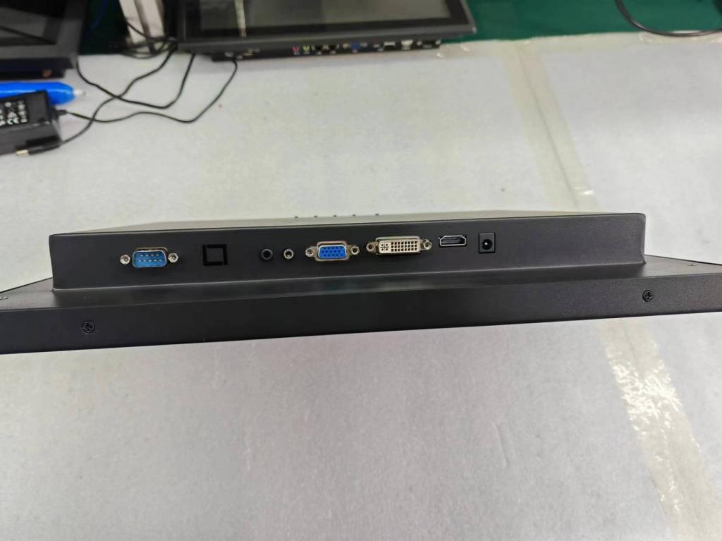

For some months now, I have been chatting with a Chinese supplier of industrial touch-monitors. I was looking for a TS with serial output. These guys supply these but I couldn't get through to them that I need the protocol. They just couldn't understand this. "We have driver" Yes but for PCs with operating systems...no good for MCUs.
Anyway I think it finally clicked and I just received this:
  Quote  Touch screen serial port communication protocol
Baud rate: 9600, data bit: 8, stop bit: 1, check bit: N. The format of the data packet sent (a total of 10 bytes):
55H, 54H, DO, D1, D2, D3, D4, FFH, 00H, D5 Among them: 55H, 54H---data packet start character.
D0---touch state, start touch is 81H,
keep touch is 82H, lift is 84H.
D1---touch point X coordinate low 8 bits.
D2--touch point X coordinate high 8 bits.
D3---touch point Y coordinate low 8 bits.
D4--touch point Y coordinate high 8 bits.
FFH, 00H---data packet end character.
D5-check byte, D5=D0+D1+D2+D3+D4-AEH, if greater than FFH, take the lower 8 bits, if less than 0, take the complement. If the check byte is wrong, abandon the data packet.
Note: Data will be sent continuously while the button is pressed, with one data packet every 30ms or so.
This could be good news because I really need a touchscreen for the CMM2.
I already interface with the serial output of the ELO-Touch but those are £500 touch monitors...not exactly hobbyist friendly.
I'll see about grabbing one for test.
