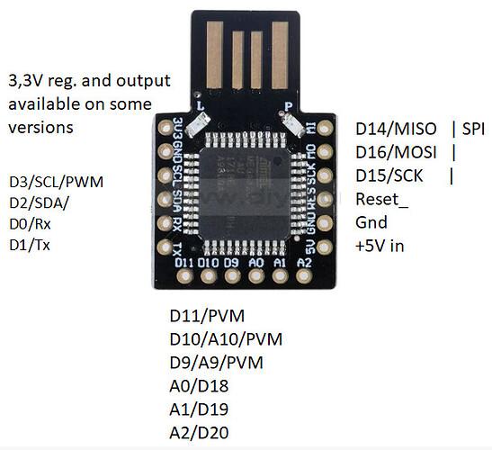

I have been looking at using the Waveshare RP2040-Zero as a HID device.
I am using the Arduino Leonardo know as BadUSB to give me keyboard and mouse
operations with the push of a single key.
My next step is to add SDcard with definitions for each button so no need to
redo the program with new changes in what buttons do.
Eventually looking to build this.

What it will do is map keys from keypad to keyboard and mouse functions.
 Not pass on the keys on the keypad but a macro that can be mixed key and mouse
 under any key. The map would be on the SDcard so the mapping can be done
 without reprogramming the pico.
 I am using custom mapped alt+x keys to do things as I can not use my right
 hand yet. Here is my Minecraft 5 button arduino device. Saves me a lot of
 typing that is hard to do one handed.
