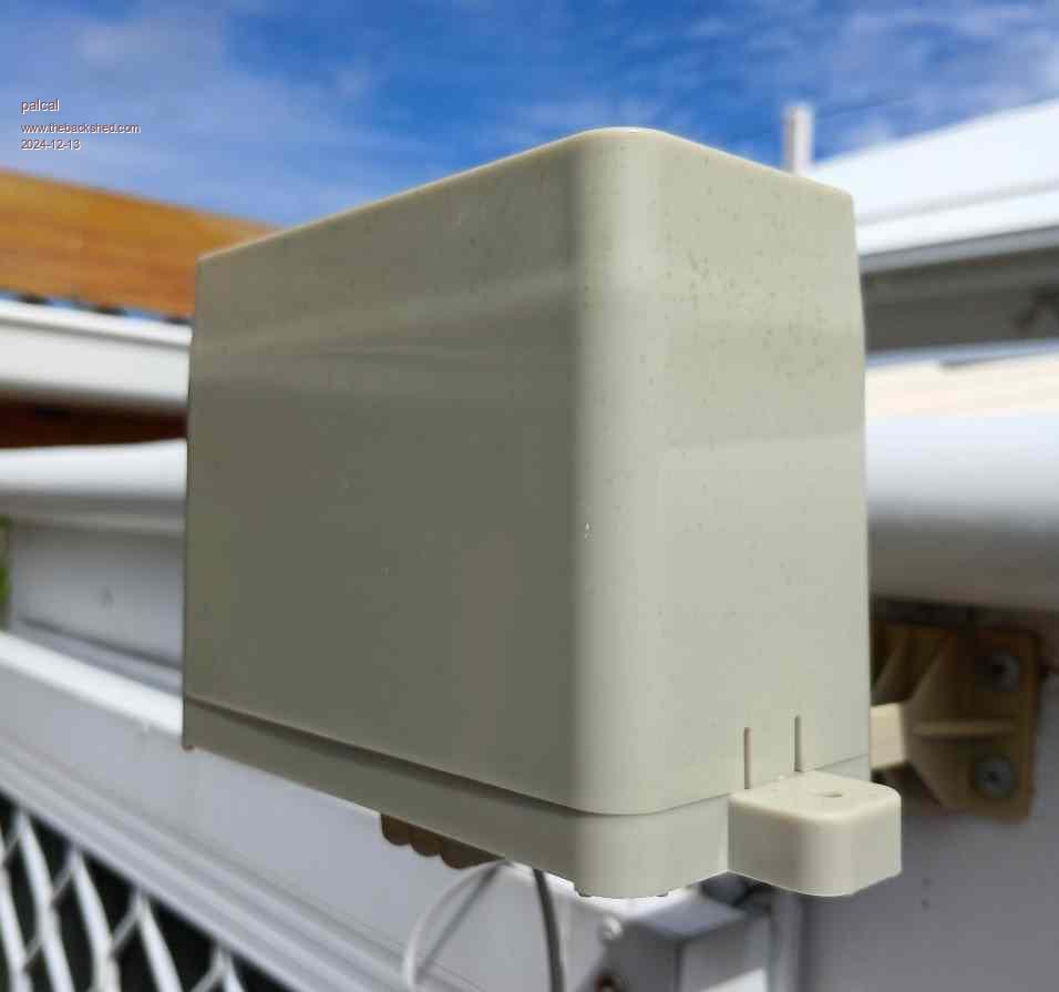

Any one using one of these rain gauges ?   Could you tell me what calibration value you use. I set this up some time ago but haven't had much rain till now. I was using 0.31mm per tip but it read 59mm for 52mm of rain so I figure the correct value to be more like .27mm per tip.

Oops the picture did not load.
Tried again but it won't upload.

What I did with an old DSE one I have was to get a parallel sided tin with the same diameter as the opening (100mm), filled it to a known depth say 20mm & gently poured the contents slowly into the gauge to see what it read. (should read 20mm if calibrated correctly).
Mine only had 1mm resolution with a 100mm opening at the top. I 3D printed a funnel with a 141mm diam opening (2 x the area) & sat that on top. Mine also has a mechanical screw adjustment in the tippers (buckets) & I was a able to get it to read 0.5mm each tip fairly accurately by adjusting that.
A calibration figure should be able to be calculated if there is no mechanical adjustment.
Hope this helps
Brian
Edit. Just saw your piccie. Bit slow typing. Probably not much help then...

I calculated the catching surface area of the rain gauge and did a similar thing with a known amount of water and that is where I got the figure of .31mm. but it doesn't seem to be accurate.

It looks like one I had. If so about .28mm is what I used.
The best way to calibrate it is with a 'real' old fashioned one close by.
Bunnings have a few to choose from.
You will find that one will read higher when it's windy and the other one will like calm steady rain.
I have 3 different gauges and they agree 'some of the time'.

Thanks Jim .28 sounds good I figured .273. I'm up in the tropics so it's going to start raining big soon. What electronic gauges are you using ?

Thanks Mick, I'm just using the switch in the rain gauge to count on a Picomite. I had it calibrated ok to read the same as my tube gauge but recently we had 52mm. overnight and it read 59mm. I'll just calibrate to the tube gauge again.

I am not sure where you have the tube gauge but looking at the photo of the tipping bucket, you will get lots of splatter from the roof with heavy rain. That will give higher readings.
I would wait for a range of comparisons before I re-calibrated.

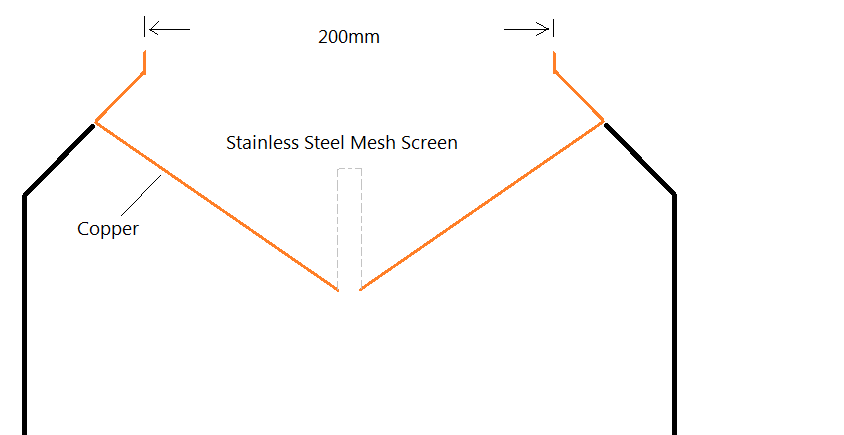

Yarra Valley Water have an "official" gauge here on top of the Divide. It has a copper funnel to prevent gunk growing in it and a very fine stainless steel screen to keep everything, including spiders out of the works. The inverted lip is a splash catcher to minimize losses in heavy rain. The slope of the housing prevents rain splashing in. The vertical rim is fairly sharp to split large drops for maximum accuracy.
It's a lot of trouble to go to given that, as observed by Jim, just a few tens of metres away the reading could be different.

@ Jim,  I moved the gauge this morning, higher up,  on to the timber you can see top left of photo where it wont get any splash. I hadn't thought of the splash effect, I just moved it to what I thought was a better position.
