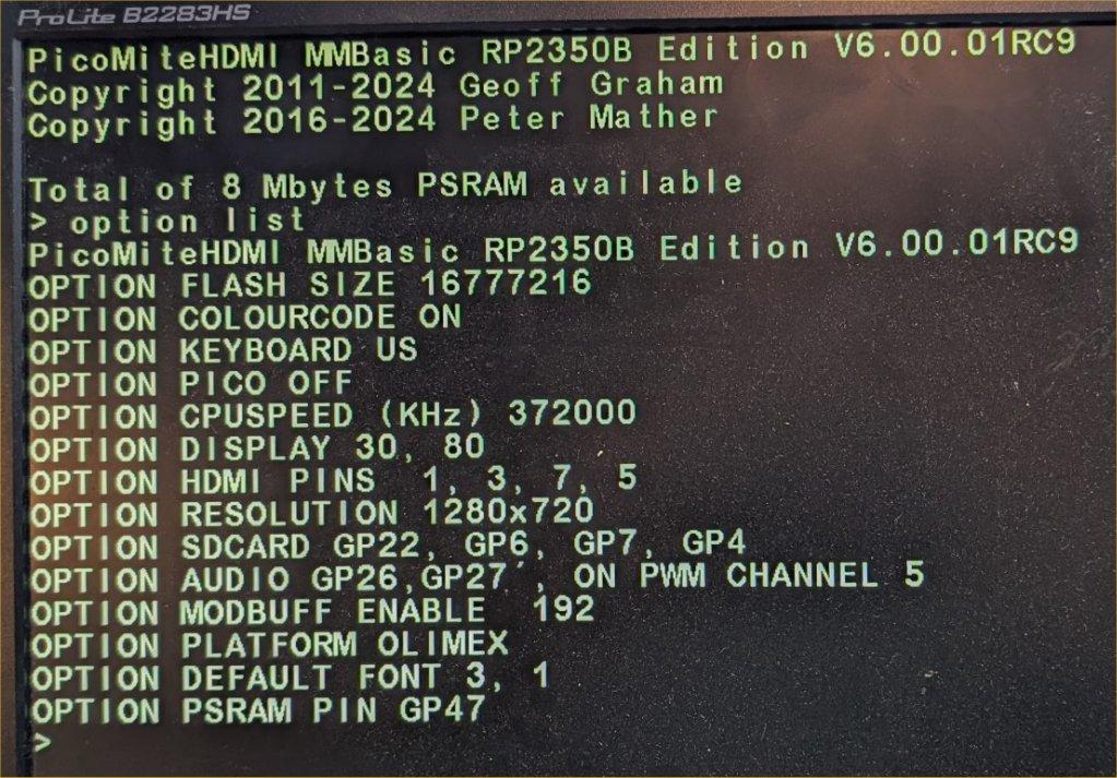

Transpires there is a bug in the sdk that resets the PSRAM timings when you write to flash. I've put in some code to restore them after flash writes and now the Pimoroni Plus can run at 372 or 378MHz allowing widescreen HDMI. Also tested on PGA2350

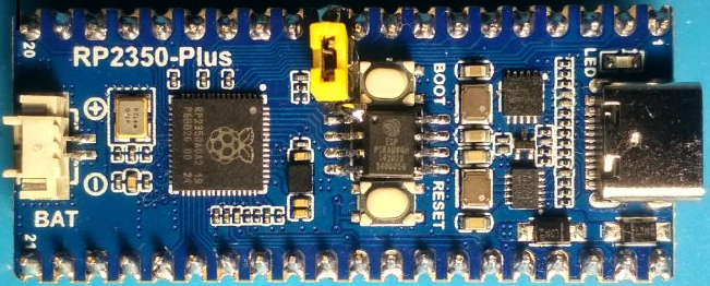

  lizby said  Exactly which PCB is this?
For example, in my experiments with PSRAM I use a Chinese clone of Pico2 called RP2350-Plus to which I soldered the PSRAM chip on top of the flash memory chip.
To select the PSRAM chip, one port of Pico2 is used, in my case it is GP8.
Edited 2024-12-22 11:03 by javavi

More info - not good though
It now appears that the tuning of the timing is probably dependent on the specific RAM chip used. I'm tuning based on the ram used by Pimoroni but it may not suit other RAM variants. I can just get the 372MHz required for 1280P HDMI video but can't reliably get 378MHz. Sometimes it boots and sometimes it doesn't so I'm limiting the clock speed to 372MHz for standard PicoMite and 315000 for PicoMiteVGA

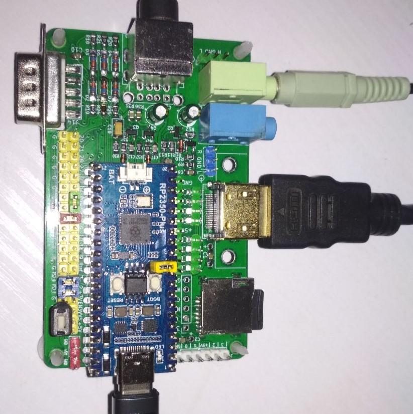

@Javavi
The board that carries the RP2350 looks nice. What is this..got a link?
javavi
Joined: 01/10/2023
Location: Ukraine
Posts: 620
Posted: 06:30pm 22 Dec 2024
  dddns said  @Javavi
This board is the so-called Murmulator 2.0
The second version, unlike the first versions of Murmulators, is still in the development stage. The purpose of redesigning the circuit was to create a Pico2 on the RP2350A with HDMI support.
PicoMite HDMI works great on this board, including PWM sound, PS/2 keyboard and mouse, SD card, and it is also possible to connect an external USB Hub.
Murmulator boards are an inexpensive solution for credit card-sized development boards for creating retro console emulators on the RPi Pico.
There are many emulator firmwares, but only for Murmulator 1.x.
For Murmulator 2.0, I think there is only ZX-Spectrum at the moment, but this is just the beginning of the promotion.
