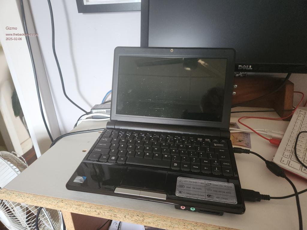

Posted: 05:54am 06 Feb 2025
I bought this netbook on the weekend for $20. It runs Win7 starter, has 1Gig ram, 250G hd. Intel N450 at 1.66GHz, web cam, 10inch screen, wifi and network connector. 2 USB, card adaptor, VGA out and audio
It boots up and runs fine, actually very snappy. Win7 complains its not authentic and its very outdated, none of the modern browsers will install.
So I'm wondering what to do with it. Tempted to install a Linux distro, any suggestions? Thinking maybe as a terminal for programming over a USB/Serial adaptor.

Gizmo,
Depends on what you want to do with it.
Browse the internet: ditch it. don't even try. Even if you get it to work, it will be very slow. There are NO recent kernels anymore that support the build in video accellerator so you need to use framebuffer (the celeron has to do all the graphics).
I think you will need to fall back to an older linux, or maybe XP may run on it.
Maybe Ubuntu 12.04 will work. Ubuntu is know to have build in compatibility with a lot of hardware. I remember there even was a special "ubuntu netbook edition"
Or try Puppy Linux. On the puppy linux forum you can ask advise what would work best.
In linux the most critical HW relation is in
1/ touchpad
2/ audio
3/ WIFI
4/ screen backlight
In most cases keyboards and video work oob, as does an external mouse.
P.S. this is a 32 bit core. It will not run 64bit os. Ironically one of the few browsers that still compile to 32 bit is Chrome. Most only offer 64bit.
P.P.S. On a 3 years more modern netbook I ran Ubuntu 16.04. Until it broke down 1 year ago.

Posted: 08:30am 06 Feb 2025
Bryan,
The n455 core is from 2010. Any distro before it (Ubuntu 6 or 8) will not have a kernel that supports the peripherals. The netbook is probably from 2011/2012. Earlies that would work is Ubuntu 10, but I know 12.04 has had a very long support time. That is probably your best guess, -or- the Ubuntu Netbook edition.
netbook edition
P.S. I have Ubuntu 8.04 disk. Nowadays you cannot imagine that anymore, but at that time Canonical send out FREE CD's if you wanted them. I received one in the normal mail.
Edited 2025-02-06 18:37 by Volhout
Posted: 09:25am 06 Feb 2025
XP is not a bad choice, but not for web browsing - or, indeed, getting anywhere near the internet!
linux mint 19.3 will work, and available for 32-bit. PLUS, the nice folks from Mozilla will offer to upgrade your firefox to the current version built for 32-bit i686; i've recently had a couple of machines running 19.3 (one 64-bit, the other 32-bit) out of the blue offer in the browser to upgrade. the instructions are fairly easy to follow and gives you ongoing firefox upgrades via Mint's update manager.
btw, your machine will almost certainly accept a 2gb SODIMM, which while not ideal (4gb would be ideal) will still help considerably. both the above mentioned netbooks have just 2gb.
rob   :-)

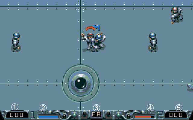

Posted: 04:38pm 06 Feb 2025
Turn it into an Amiga!
https://www.youtube.com/watch?v=kbDJBZQ-NR4
Edited 2025-02-07 02:41 by PeteCotton
